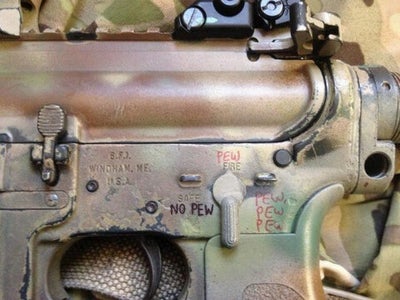

The first thing I did was take construction paper and make a mock up of the holster to see if it was even possible, and if so, how the Kydex would need to be laid onto the pistol. This is where you have to visualize a lot if your item has a lot of protrusions/depressions. You want the Kydex to take the form as tightly as you can, but there has to be room for the item to slide out - Kydex won't flex out of the way of a trigger guard, mag release, etc.
Step 2: Prepping the Item
Patience, that's the name of the game at this point. Visualize how the item will slide in and out - what protrusions could catch, will the trigger get caught, or the mag release? Is there a deep depression that will lock the item in and prevent it from coming out at all? IS THE SAFETY CLEAR???
As I worked with the pistol I made various ramps, channels, and raised mounting points to accommodate a snug fit with several key locking points, while clearancing areas that would be "bad" to unexpectedly get pushed, pulled, or snagged.
Popsicle sticks, dowels, washers, even a carpenters pencil all worked in this instance to make the necessary shapes to allow a functional safe holster. It took two full evenings to carefully apply, check, and re-apply the tape and sticks until I could be sure it was going to work as I wanted it to.

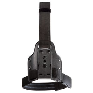

For a first effort I was giddy when I removed the foam. The weapon slid in and out with good tension and no hangups. Decent but not fantastic definition of the contours (probably not enough pressure and/or not enough heat in the sheet). I took a Dremel and proceeded to cut away the excess material and smooth the edges. I drilled the holes and mounted the holster to the thigh rig, again without a hiccup.
I strapped it on to get a feel for how good or bad this was actually going to be. Kydex comes in different thicknesses, and I chose some in the middle of the road. It is a bit too thin to securely hold the pistol during normal activity without a thumb break, but for a weapon of this size that is to be expected. But the final position is perfect, falls right to my hand for easy removal/replacing, doesn't impeded active movement, carries the weight so well you hardly know it is there.
I should have gotten some sleep at this point but proceeded to crudely address the securing problem instead. I borrowed a strap from a bug out bag and looped it through the mounting screws on the back of the holster. I then took the Dremel and cut a "U" shape in the front side where the catch would be. Using a heat gun, I softened the Kydex up and rolled the "U" down to make the catch for the thumb break to go into. I also put a small piece of velcro for the break to stick to so it wouldn't raise up and catch on anything. It is big enough to grip and release with gloves on, and is quite elegant in function, just not in the looks department. Now the pistol is tight and secure, even when running and climbing.
