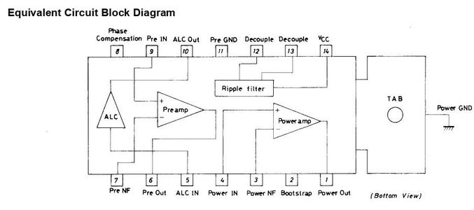

Block Diagram of LA4160 IC:
Block Diagram of LA4160 IC is given on the step -1
Step 1: Block Diagram of LA4160 IC
BLOCK DIAGRAM OF LA4160 IC
The block diagram of LA4160 IC has been given the following image. Having a look at the block diagram
