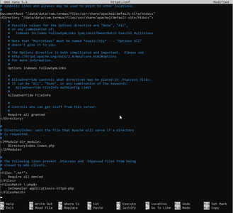

Now, scroll down until you find the section header:
DocumentRoot "/data/data/com.termux/files/usr/share/apache2/default-site/htdocs" <Directory "/data/data/com.termux/files/usr/share/apache2/default-site/htdocs">
A few lines down, you'll see the line:
AllowOverride None
Change this to read:
AllowOverride FileInfo
Immediately below this, you'll see a block:
<IfModule dir_module> DirectoryIndex index.html </IfModule> <br>
Change index.html to read index.php and append the following code immediately below that block:
<FilesMatch \.php$>
SetHandler application/x-httpd-php
</FilesMatch><br>That should be everything. I've attached a screenshot of the latter part of this for reference. To save the file, type Ctrl-O and press Enter, and it should say "[Wrote XXX lines]" at the bottom of the screen. Type Ctrl-X to exit nano.
NOTE: If you think you may have made some mistakes, and want to exit nano without saving, type Ctrl-X and type "n" when prompted "Save modified buffer?"

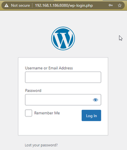

Step 9: Get Connected!
Right, we've installed everything we need, so let's get connected to Wordpress.
We need to launch the apache web server, so type:
httpd
That should be the system running.
Open a browser, and type this into the address bar:
http://192.168.1.186:8080
(replacing 192.168.1.186 with your own IP address)
Follow the prompts for installing Wordpress. Database name is wordpress, username is wordpress and the password is whatever you set up during the MySQL install step.
