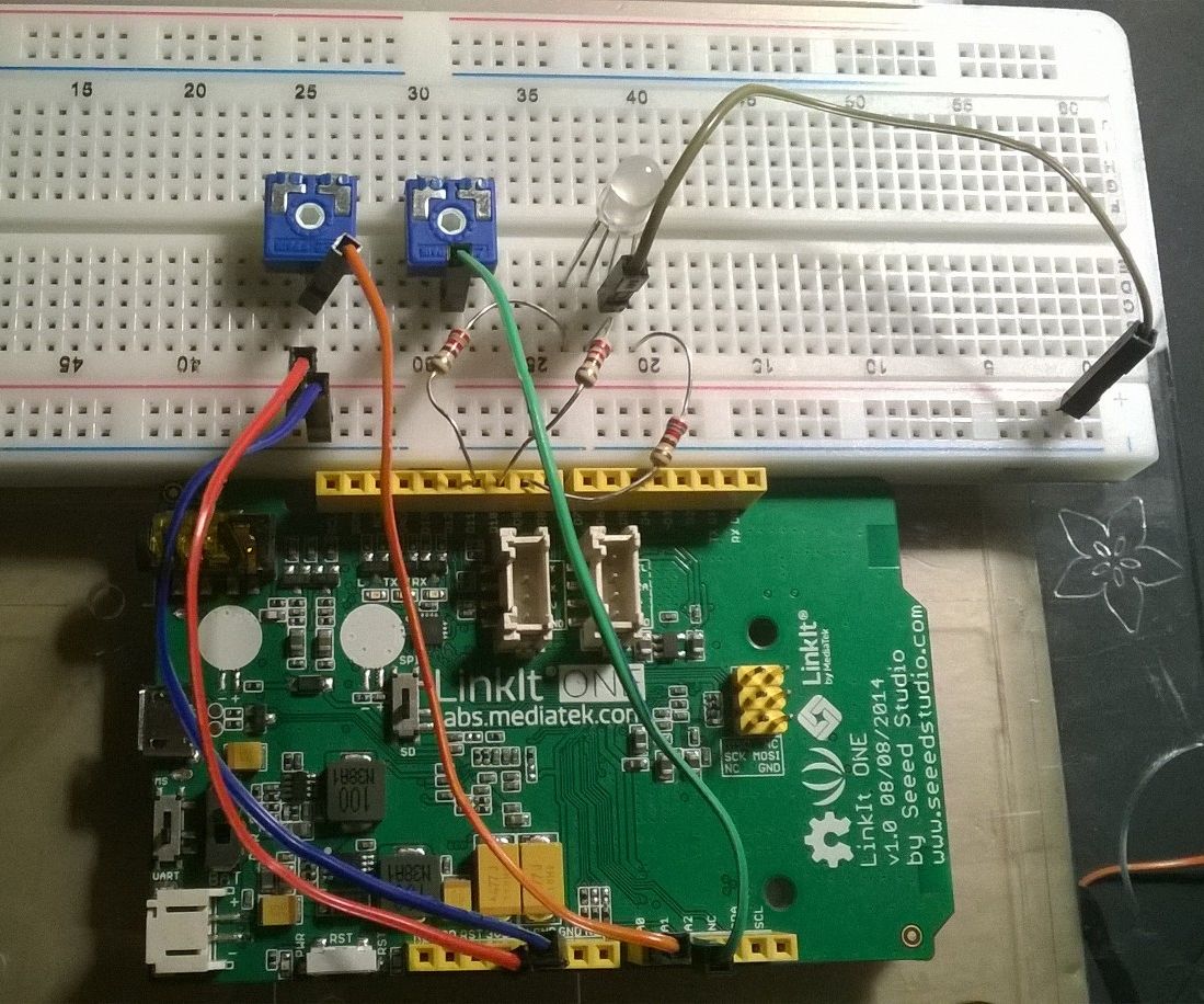

Step 2: Wiring
Follow the wiring directions outlined in the images.
Remember that in the second image, the pins are reversed, since the LCD is upside down. You can choose to do this if it makes it more convenient, as it will allow you to route the wires directly to the board instead of around or over the display, potentially obscuring your view of it.
After you are done, plug you LinkIt One board into your computer. The display should light up. If not, check your wiring and try again. Some LCD displays have differing wiring schematics for the backlight. If this is the case for you, check another source to verify your wiring.
