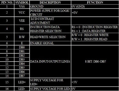

The basic data of the 16x2 lcd are given by
FEATURES
• 5 x 8 dots with cursor
• Built-in controller (KS 0066 or Equivalent)
• + 5V power supply (Also available for + 3V)
• 1/16 duty cycle
• B/L to be driven by pin 1, pin 2 or pin 15, pin 16 or A.K (LED)
• N.V. optional for + 3V power supply
And the pin diagram of the lcd is given in the pitcures above and the functions of the pins are also given above with each pin defination

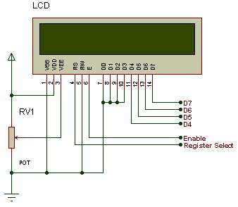

Step 3: Creating the Basic Shield for the LCD to Work
by using the following circuit diagram of the shield making for LCD and as you have already watched the video you will get some basic idea about the circuit diagram of the lcd and their connections
The pins which we are going to use to connect it to any external microcontroller or microprocessor
RS(PIN=4)
E(PIN=6)
DB4(PIN=11)
DB5(PIN=12)
DB6(PIN=13)
DB7(PIN=14)

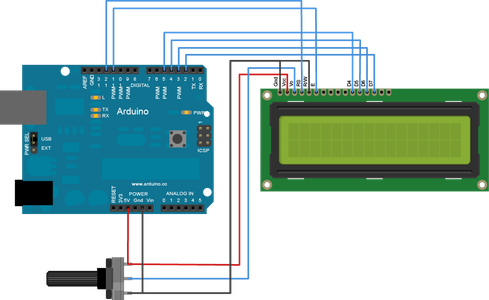

Step 4: Connecting to Arduino
To make the LCD to work with there is one missing component that is microcontroller that could be any like the 8086 or pic microcontroller in my case i have used a arduino uno
The pins which are being used in the following session are
Arduino pins LCD pins
12 RS
11 E
5 DB4
4 DB5
3 DB6
2 DB7
connect all the following wires to the arduino and the LCD
