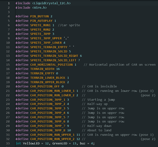

Step 5: Part 1 of Code
Libraries
#include <LiquidCrystal_I2C.h>
#include <Wire.h>
These lines include two libraries: LiquidCrystal_I2C and Wire. LiquidCrystal_I2C is commonly used for interfacing with LCD displays over I2C, and Wire is used for I2C communication.
Definitions(All the lines that have #define infront of them)
These are preprocessor macros that define constants. They are used to make the code more readable and to avoid using "magic numbers" in the code. For example, PIN_BUTTON is defined as 2, which makes the code more understandable than using the number 2 directly.
Variables
int YellowLED = 12, GreenLED = 13, buz = 4;
These are global variables. "YellowLED, GreenLED, and buz are assigned pin numbers for LEDs and a buzzer. This suggests that the project involves controlling LEDs and a buzzer using an Arduino.

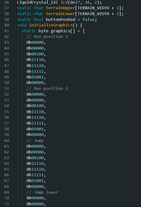

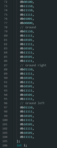

Step 6: Part 2 of Code
This piece of code sets up a 16x2 LCD display connected through I2C communication on the Arduino. It also defines two static arrays to store characters representing upper and lower parts of the game terrain. A boolean variable is initialized to keep track of whether a button has been pushed. The code introduces a function called initializeGraphics() that creates a series of graphical patterns using binary numbers. These patterns represent different poses of a character in the game, like running and jumping. The code ends by declaring an integer variable i, likely used for iterating through the graphical patterns in the later parts of the program. In simple terms, this code segment is preparing the visual elements needed for a game or animation to be displayed on the LCD screen.
Step 7: Part 3 of Code
In this part of the code, it's setting up a display for a game or animation. It creates custom characters for different sprites using the lcd.createChar() function, which makes it easier to draw these characters on the display. Then, it initializes arrays to represent the upper and lower parts of the game terrain as empty spaces. The second part defines a function called advanceTerrain that makes the terrain shift to the left in small steps. The function looks at each part of the terrain and decides whether to show an empty space, a solid block, or move a block left or right. This creates a scrolling effect, making it look like the game or animation is continuously moving forward. Overall, these steps help set up the visual elements of the game or animation on the display.

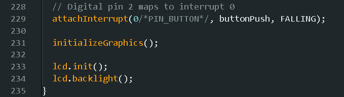

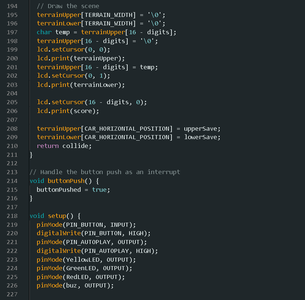

Step 9: Part 5 of Code
This piece of code is like the artist's brushstroke on a canvas. It's responsible for showing things on a small screen. Imagine the screen is split into two parts, like upper and lower sections. The code manages the drawings on these parts. It does things like displaying a score at a particular spot and handling a button press. The button press is like a special event that the code pays attention to. The setup function at the end prepares everything before the drawings start. It's like setting up the colors and tools before an artist begins their work. So, in simple words, this code is about making things appear on a screen and getting ready for the action to begin.
Step 10: Part 6 of Code
This code is like the brain of a simple game on an Arduino. The game has a car that moves on a screen. The loop function does different things depending on whether the game is just starting or already in progress.
When the game is not running, it shows a blinking car or a message saying "Press Start" on the screen. If you press a button to start the game, it sets up everything for the game to begin.
When the game is running, the loop makes the car move forward and generates new obstacles on the screen. It also checks if you press the button to make the car jump. If the car hits an obstacle, the game ends, and lights and a buzzer might make noise to signal the end of the game.
