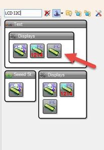

  • Add "Liquid Crystal Display (LCD) - I2C" component

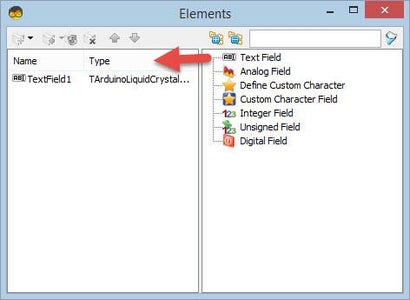

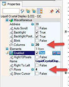

  • Select "LiquidCrystalDisplay1" and in the properties window depending on the type of your display set the number of Columns and Rows in this case "Columns" 20 and "Rows" 4
  • Double click on the "LiquidCrystalDisplay1" and in the elements window Drag "Text Field" to the left side and in the properties window Optionally set "Width" to 20, different Row if you want or Colums, Experiment to see what fits you.
