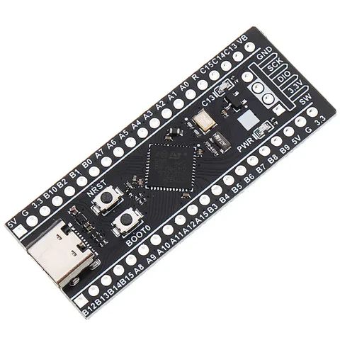

The STM32 Black Pill is a small, powerful microcontroller board based on the STM32F103C8T6 ARM Cortex-M3 processor. It has a rich set of peripherals, including GPIOs, UARTs, SPIs, I2Cs, and more, making it suitable for a wide range of applications. In this tutorial, we will learn how to display "Chitkara University" on a 16x2 LCD using the STM32 Black Pill and STM Cube IDE, without using an I2C module, but instead using HAL (Hardware Abstraction Layer) programming.

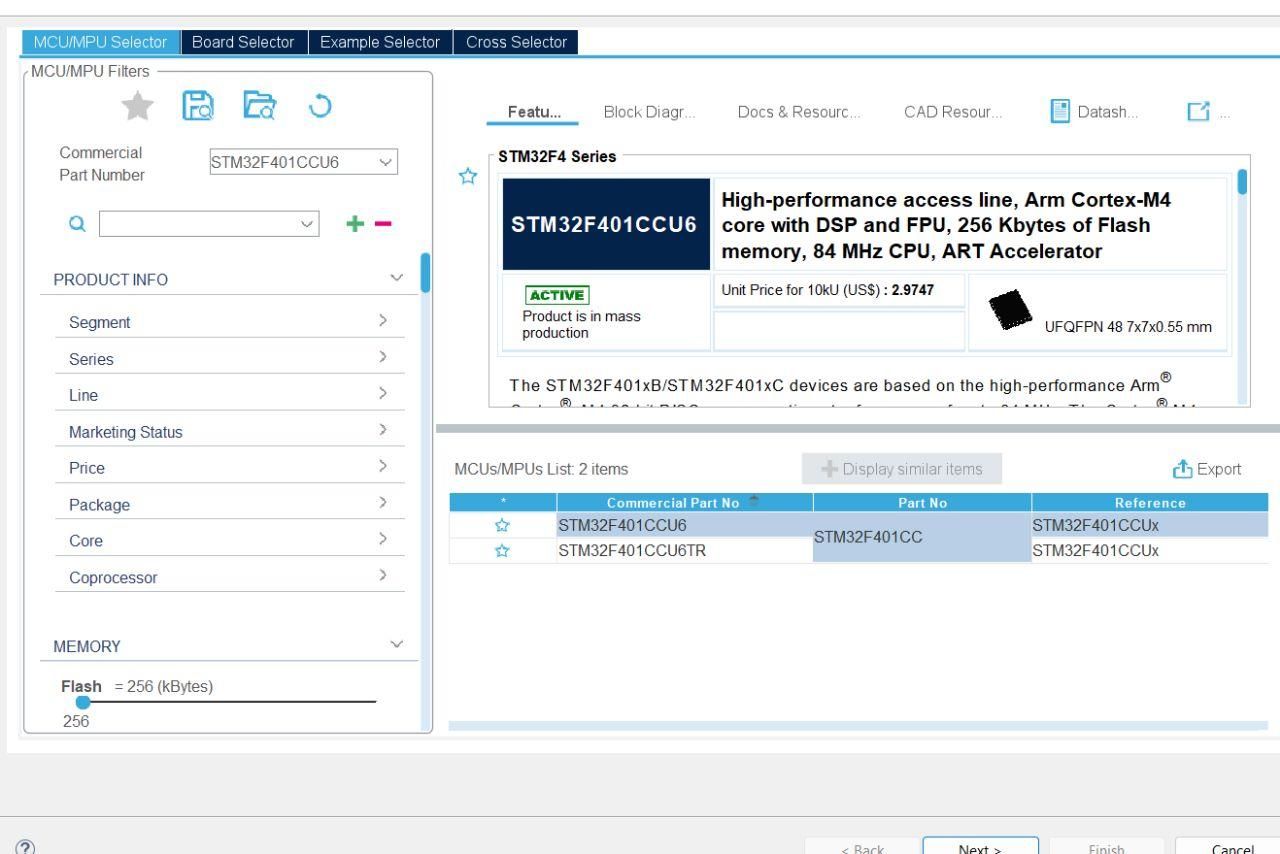

1.Open STM32 Cube IDE and create a new Project.
2.Select the board (STM32F401CCU6) and click Next.

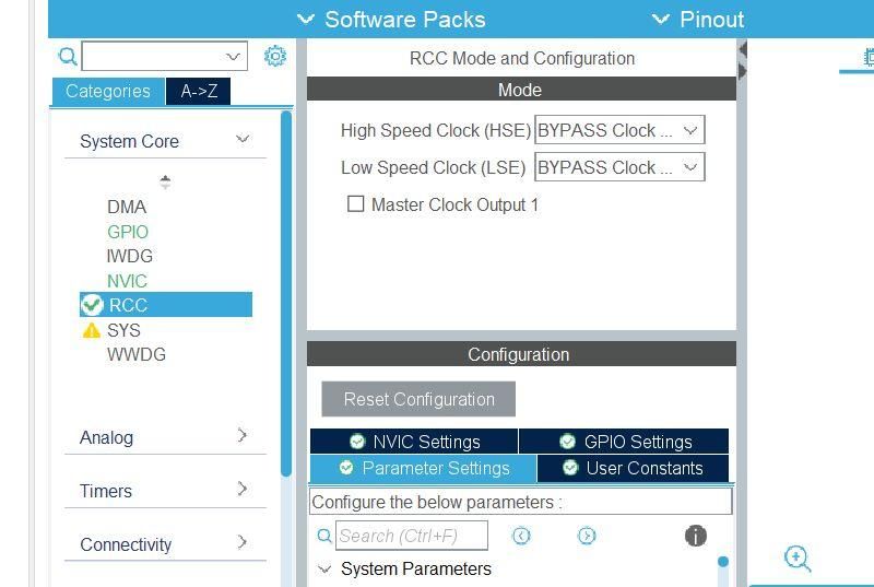

5.In System Core menu , select RCC.
6.Set the mode of High speed clock and Low speed clock to "BYPASS Clock Source".

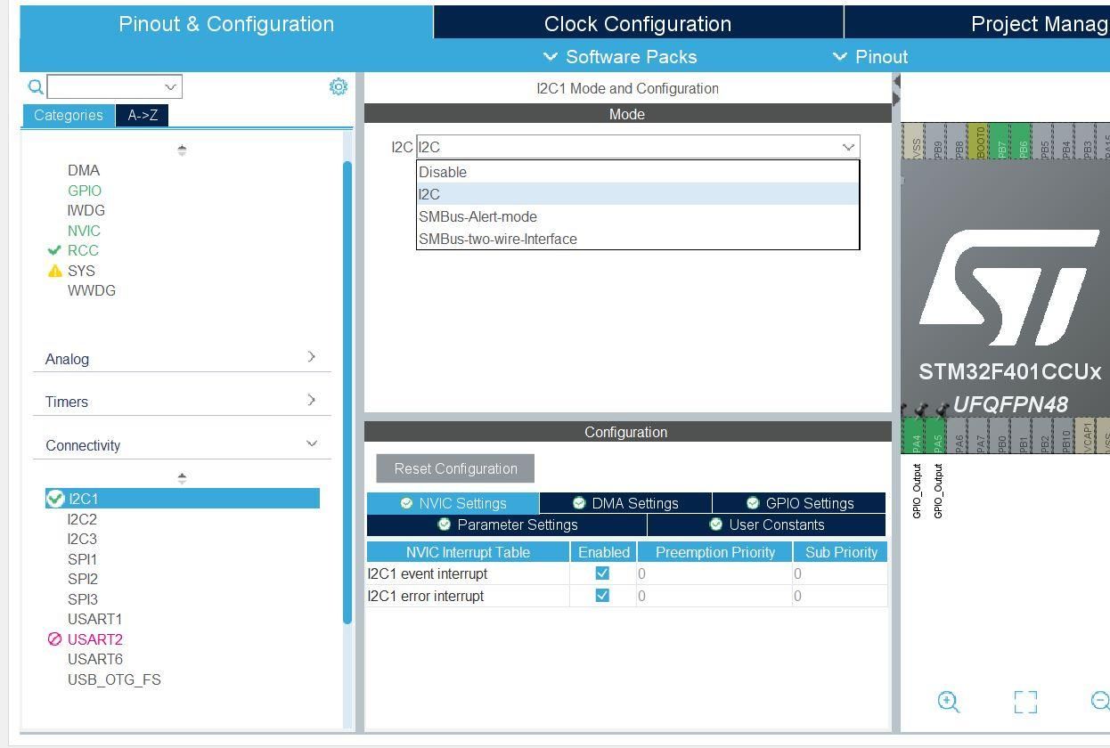

8.Now, in the Connectivity menu , select I2C1 and do the following settings.

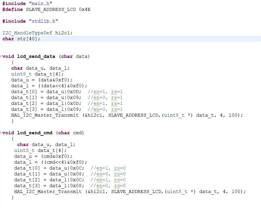

9.After doing all the above steps, open the main.c file.
10.Now,write the following code.

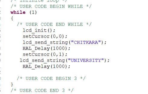

11.In the while loop statement, write the following code.
