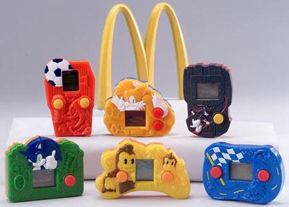

I have fond childhood memories of those little sonic LCD games that you could get from McDonald's in the mid 2000's. Sadly, any I had have been lost or thrown away over time.
So, I decided to take matters into my own hands - and make my own LCD game!

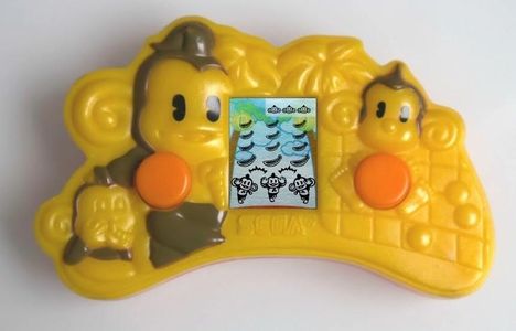

In this game, the player uses 2 buttons to move their character left and right, trying to collect all the coins that are falling from the sky. It was designed to resemble an old Sega LCD game where you have to catch falling bananas.

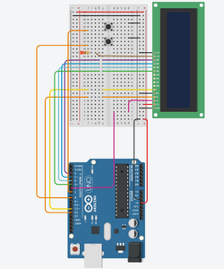

Before I started physically building anything, I wanted to simulate everything digitally. I decided to use Tinkercad for this purpose.
For the circuit, I connected the LCD to pins 2-6, 11 and 12 as seen in the diagram. I made sure to use a 220 Ohm resistor when connecting the LCD to the 5V power.
I connected the buttons to pins 7 and 8.

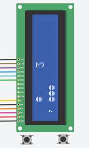

The game itself is pretty simple. The game moves all coins down 1 space every second, and then randomly spawns new coins at the top. The player moves left/right if the buttons are pressed. If the player touches a coin, it disappears and adds 1 to the score.
The biggest issue was that I needed 3 columns for the falling coins - but the display only has 2! This meant having to virtually split the display into 3 columns, using custom characters to actually display the coins and player.

I soldered 12 wires to the LCD. Then I connected the LCD and the 2 buttons as in the diagram, using a small breadboard for the power and ground wires. Finally, I uploaded the code and crossed my fingers.
And... it works! Luckily, all the components behaved just like they did in the simulated version.
