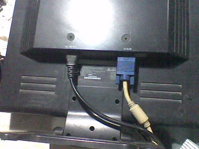

I turned on my #6 PC today and no monitor. Black! After checking the power cable and VGA cable, still nothing. So what do i do, Well i take it apart of course! What i found was all 6 of the power supply caps were no good. Only took a visual inspection to determine the problem due to the tops of the caps were pushed up.
This is an internal power supply LCD. Some Flat screen LCD's have a external power supply with a dc plug that plugs in to the back of the LCD.
This is a TG model made by Sampo, from China.

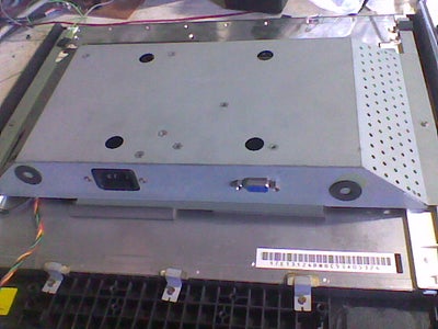

Remove the cables. This model has 5 main screws at the bottom hinge area. The rest of the cover is snap together. When you get the back cover off you will see this tin cover. Remove this cover. Take care as there is several wire connectors that need to be unplugged to get the cover off.

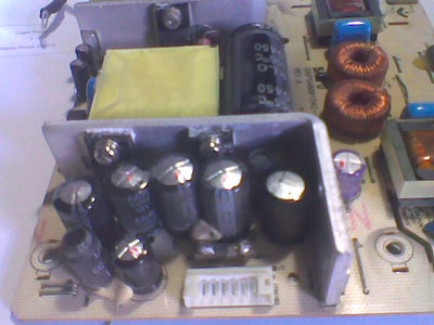

Then you will see two PCB's. The smaller one is the controller board, leave it there it is not the problem. The larger PCB is the power supply board. Thats the problem, continue to remove this board.
Some LCD's have more boards than others. You will have to look for your model online if you can not determine what board is what.

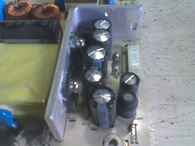

Hopefully you can see from my pics the 6 caps with the tops pushed up. Those are the problem.
I replaced all 6 caps. Even if there were only 2 or 3 bad caps i would replace them all.
Make yourself a map of where everything goes so its it is easy to install them later.
