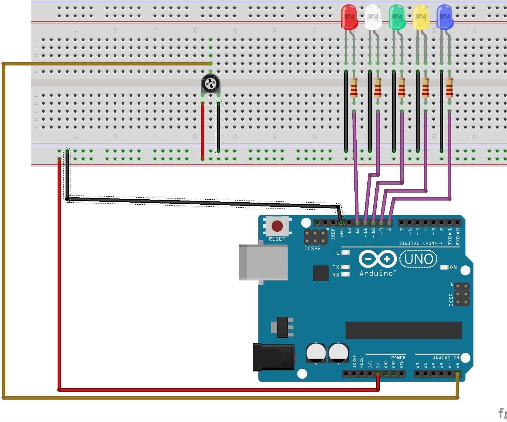

Step 2: Connecting the LCD Screen Using 74HC595 Shift Register
I started connecting from the left, beginning at pin 16 on the LCD screen. Pin 16 is connected to the ground rail, and pin 15 to power. The next four pins will be connected to the 74HC595 chip.
- LCD pin 14 to 74HC595 pin 7
- LCD pin 13 to 74HC595 pin 6
- LCD pin 12 to 74HC595 pin 5
- LCD pin 11 to 74HC595 pin 4.
The next four pins on the LCD screen will have no attachments.
LCD pin 6 to 74HC595 pin 3.
LCD pin 5 will be connected to the ground rail, and pin 4 will go to 74HC595's pin 1.
LCD pin 4 will connect to the potentiometer. Finish up the connections for the LCD screen by connecting pin 2 to power, and pin 1 to ground.
Step 3: Connecting 74HC595 to Arduino
Before connecting the 74HC595 to the arduino, I finished the potentiometer's connections by connecting the left side to power, and the right to ground. In addition, I added power and ground connections for each side of the breadboard.
Pin 8 on the 74HC595 chip will be connected to ground (which is why I used the extra connections for each side of the breadboard). Pin 10 of the 74HC595 will be connected to power.
Pins 11, 12, and 14 of the 74HC595 chip are connected to pins on the Arduino. Pin 11 was connected to pin 13 on the Arduino.
ERROR IN FRITZING DIAGRAM: The diagram shows that 74HC595's pins 12 and 14 are connected to 11 and 10. This is wrong, and will prevent words from printing to the screen. Pin 12 on 74HC595 should connect to 10, and pin 14 should go to the Arduino's pin 11.
74HC595's pin 13 will be connected to ground, and pin 16 will go to power.
Step 4: Connect GND and 5V (and Test)
Last, connect the breadboard's power and GND to the Arduino. Now the LCD screen should run using only three pins on the arduino as opposed to the usual six.
