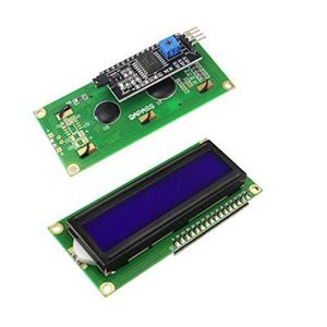

Step 1: Interfacing I2C LCD With ESP32 :
In this section, we will see how to connect I2C LCD with ESP32. The I2C LCD will be connected with the ESP32 board with its 4 pins (GND, VCC, SDA and SCL).
Follow the schematic diagram for the ESP modules and connect them accordingly. If you are using ESP32 for this project, connect the ESP32 device with the I2C LCD as shown in the schematic diagram above:
The VCC pin is connected with the 5V pin from the ESP32 to power up. Both the grounds of the two devices are connected in common. The SCL pin of I2C LCD is connected with the default SCL pin of the board. The SDA pin is connected with the default SDA pin of the board.
I2C LCD Pinout :
This display has four pins:
1. GROUND
2. VCC
3. SDA
4. SCL
The connection of I2C LCD with the ESP boards is very easy. We have to connect the VCC terminal with 5V pin, ground with the ground (common ground), SCL of the sensor with SCL of the module, and SDA of the sensor with the SDA pin of the ESP modules.
The connections between the devices can be seen below:
ESP32 I2C LCD
VCC            - 5V
GPIO21(I2C SDA) - SDA
GPIO22 (I2C SCL) - SCL
GROUND       - GND
ESP32 I2C Pins:
The I2C pins stated above are set in default. If we want to change the GPIO pins we have to set them in code. The diagrams above show the pinout for the ESP32 respectively.

Step 5: Troubleshooting the LCD Contrast :
After wiring the LCD, you will need to adjust the contrast of the LCD. On the I2C module, there is a potentiometer that can be rotated with a small screwdriver.
At the backside of this liquid crystal display, you can see a potentiometer knob (blue coloured). That is used to modify the brightness of the LCD. This potentiometer is very handy when you are using this display module in different light conditions.
After the connections you will see the backlight lights up. you have to turn the potentiometer knob, the 2 rows of rectangles will appear.
If you look closely, you can see tiny rectangles for each character on the screen. If you have made it this far, Your LCD is functioning properly.
