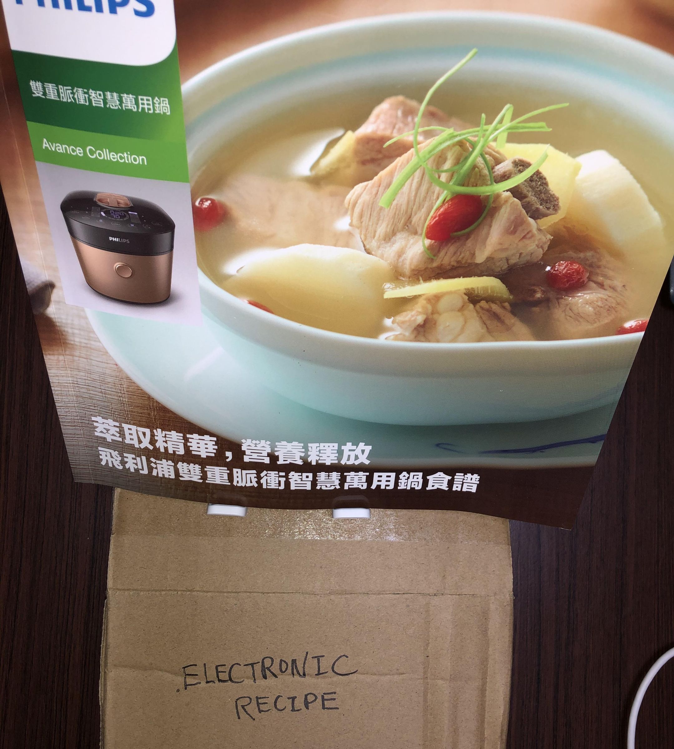

If you want your timer to be fancy, you can design a box to hide all the boards and jumpers, like shown above. Otherwise, your product should be functional! :)
