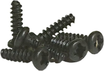

Some Screws to screw the Case together.
- I have used M1.7 x 10mm Self Tapping Screws.

Step 13: Fit the Top
To finish off, the top is held in place with four M1.7 x 10 mm self tapping screws.
