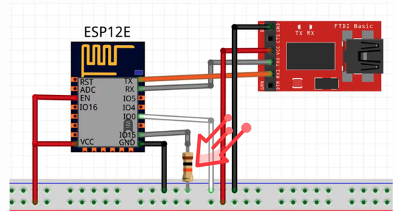

First of all I need to make sure that the ESP32 has the base Tasmota. This is very easy to do, explained on the Tasmota getting started website or just follow the Easy ESP Tasmota Programming instructables article.
The way I did this was with some stuff I had lying around (picture 1) just a 10K resistor a USB-UART and a couple of breadboard wires. And although not pretty, it worked just fine.
But since I now am using a lot of ESP8266's, 12-E, F's etc in my projects must admit that I did upgrade my setup with a cheap ESP development board from Ali for 5 Euro's.

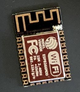

Step 4: Put in the New ESP-12

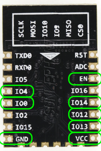

I then just soldered the ESP-12F into the same place as the WB3S chip. It is fully pin-compatible so no worries. Also, you don't need to solder all pads since only GND, VCC, EN (tied low), GPIO0, 4, 12, 13 and 14 are used (as highlighted in green in picture 2).

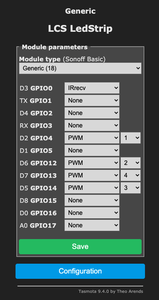

Now we just need to configure the ESP. So we go to the Tasmota webui for the IP (Picture 1) and configure the following ports:
  • GPIO0: IRrecv
  • GPIO4: PWM, 1
  • GPIO12: PWM, 2
  • GPIO13: PWM, 4
  • GPIO14: PWM, 3
Or use the following template:
{"NAME":"LSC RGBW Strip","GPIO":[1088,0,0,0,416,0,0,0,417,419,418,0,0,0],"FLAG":0,"BASE":18}

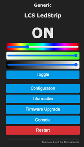

After saving that the controller should restart and you are able to control the strip straight from your Tasmota webinterface (picture 2).

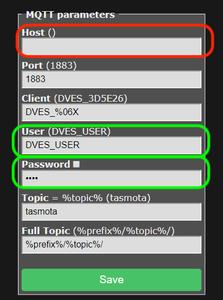

  1. In Home Assistant make sure that you have an MQTT broker running. I use the Mosquitto broker (like the majority of people I guess). And in Configuration make sure that you have your MQTT Username and MQTT Password defined. We will need this in the next step.
  2. In your Tasmota webui configure the MQTT Parameters (picture 1). Make sure that you have the IP address of your Home Assistant server filled in (highlighted in red). NO http or anything, just the IP. And enter the MQTT username and password from step 1 (highlighted in green). And Save.
Now everything should be fine and your Home Assistant should have picked up this new MQTT device. If it is not there, just go back to the Tasmota webui and at the Console enter the:
setoption19 1
command which should send all configuration values to Home Assistant.

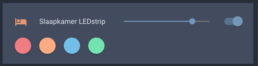

I used the rgb-light-card to control the led strip (picture 2) and here the lovelace code for that one:
