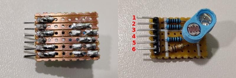

Step 2: Actual Circuit
We will make cuts in three of the six strips to the stripboard in the position shown in the first picture. Note that the view of the plate is from the side where there are no copper tracks, where we will place the components. The cuts must fall under each of the 100Ω resistors.
Then we solder the components as shown in the diagram in the second picture.
The result should be similar to the 6-pin module in the third picture.

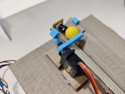

Step 4: Test Machine

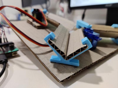

To test and verify that the sensor built is valid, we designed a simple color ball sorting machine with the sensor, a pair of servos and a micro:bit. The machine consist of a sloped rail with a servo controlled end fork.
The color sensor will scan the balls so that the machine can make decisions based on their color. Servo 1 will stop the balls at the beginning of the entry lane of the machine so that the color sensor can act. It will have two positions, one for the door closed and one for the door open. Servo 2 will control the fork at the end of the entry lane and cause the balls to be routed to either the left or right exit lanes of the machine.
We make the rails out of cardboard which we attach with small 3D printed pieces that are attached to this guide. Also attached are the servo arms that we custom design.

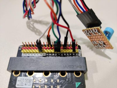

We use micro:bit as microcontroller and make the connections with sensor and servos thanks to a breakout board.
Specifically, we make the following connections:
| Device       | Device pin | Color cable | micro:bit pin |
| Color sensor | 1: B       | Green       | P8            |
| Color sensor | 2: G       | White       | P2            |
| Color sensor | 3: GND     | Orange      | GND           |
| Color sensor | 4: R       | Blue        | P1            |
| Color sensor | 5: ADC     | Red         | P0            |
| Color sensor | 6: +3,3V   | Black       | +3.3V         |
| Servo 1      |            |             | P14           |
| Servo 2      |            |             | P13           |
