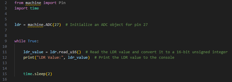

Step 3: Source Code
from machine import Pin
import time
ldr = machine.ADC(27)  # Initialize an ADC object for pin 27
while True:
    ldr_value = ldr.read_u16()  # Read the LDR value and convert it to a 16-bit unsigned integer
    print("LDR Value:", ldr_value)  # Print the LDR value to the console
      time.sleep(2)
