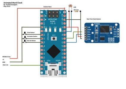

The clock runs off an Arduino Nano, the wiring is exactly the same as the 3D Printed clock, Addressable LED's have a + and gnd and a data cable

I didn't have the light sensor as shown in the wiring diagram, so i just went with the diagram apart from that and wired in the 3 switches, (the switches were installed on the side of the frame) I did this on the back of the LED board, the nano is underneath the board in the photos but its pretty much easy for the electronic's, from the nano we take 5v and ground to the LED strip and the DS3231 RTC and the data feed is from D11 at the end of the LED strip connect 5v and gnd and tie into the 5v and Ground going to the strip, creating a power loop, wire the RTC as in the diagram.
