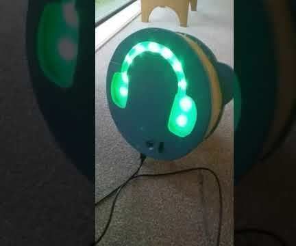

This part is fun. First cut the soda bottle around its circumference a bit down from the cap to allow you to insert a rolled up piece of photocopy paper. It will unfold against the sides of the bottle after you drop it in. Cut it a bit to fit your bottle. This acts as a shade so that the LEDs aren't too bright to look at.
I used a cling film cardboard roll (Glad Wrap if you are from NZ) to go down the centre of the bottle (you could also just use a rolled up copier paper sheet). On this I wrapped the 10 LED strip in a spiral, held in place with hot glue. Make sure the soldered pin end of the LED strip is uppermost and accessible. Glue this paper or cardboard tube to the bottom of the bottle. Next make a cardboard circle to go over the top of the bottle & paper/cardboard tube, with a notch to allow the LED wires through. Then you can connect this to the Nano and glue the Nano in place (see pics).
You'll have to look at the wiring diagram I have posted & do some of your own figuring out. Basically you want the + pin from the KY-037 sound sensor and the +5V terminal from the LED strip to connect to the 5V pin on the Nano. The GND pins from these both go to the GND on the Nano. This is where I used some spare headers soldered together. From these pins you join two wires going down through the centre of the cardboard tube and out to the USB cable which connects to the mobile phone charger. Make sure to match +ve and -ve.
Before going further I once again tested the LED strip to make sure it still lights up (no broken connections), powered both from the USB to a computer as well as from the 5V and GND.
The power supply wires I routed down through the centre of the cardboard tube and out via the bottom of the bottle. The switch goes down here - to be hot glued to the cone shaped base - so allow enough wire for this operation. I then cut my spare USB Arduino/printer cable in half, connected one end to the Nano power supply wires. The other end goes into the mobile charger. The cable has a black and a red wire, plus other data wires. Use the black (negative/GND) and red (+5V).
Step 3: FInishing Things
You'll see from the pics that I used cardboard to shape a cylindrical top for my lamp - this helps conceal the Nano board and wires. Note that I've left the USB socket accessible so that I can further program the Nano to utilise the sound sensor. I'll do this as time allows.
The base of my lamp is a cone. This is trickier to achieve. However, there is a very useful website that allows you to create a cone, PDF it and print a cone template that can be translated onto cardboard. Just measure the diameters and height you want. Here's the link: https://www.blocklayer.com/cone-patterns.aspx Mine was 167mm x 93mm x 40mm high.
I'll leave it here for now. My lamp still needs some trim and painting, plus the addition of more sophisticated code so that it responds to the sound sensor - but that can be added in the near future.
