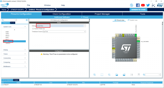

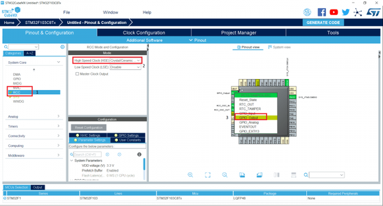

A new window will be opened where you need to change SYS Debug to Serial Wire and RCC of High-Speed Clock or HSC to Crystal/Ceramic Resonator as shown in the below fig.
Step 4:
Now in the right panel as shown in the below figure, click on the pin of the chip where you want to attach the LED and I have chosen PC13. Select that particular pin where you want to blink the LED as GPIO_output by right-clicking on that pin.
Step 5:

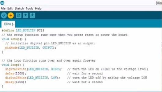

Step 8: Enter the Code in the Software
After installing the STM 32 F4 Series in the Arduino IDE Write the code for LED Blinking
