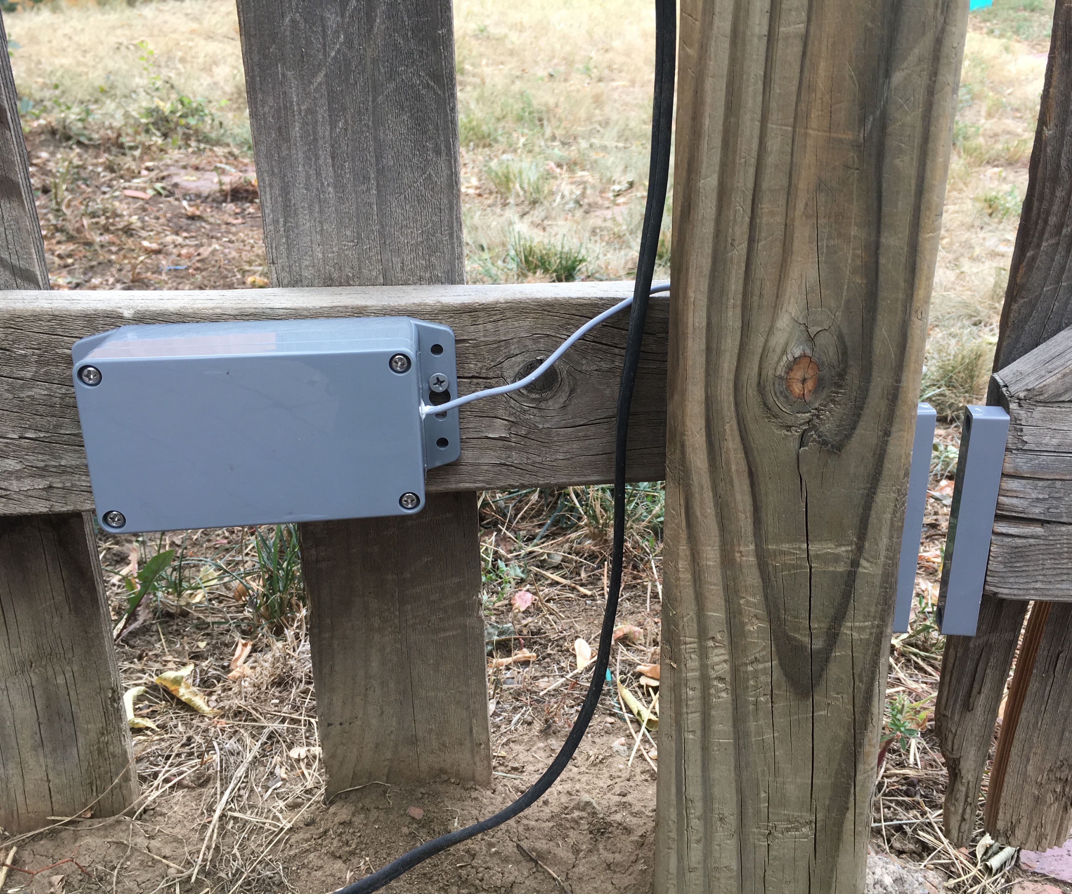

Step 6: Install Bridge Rectifier Circuit
For the bridge rectifier circuit you can build your own as I have done. It is simply 4 diodes and then a capacitor to smooth out the output. Also I installed a test LED with current limiting resistor and 1M Ohm resistor across the output to make sure I didn't blow it up accidentally by connecting it to AC without a load. I used wire nuts with grease in them for all the connections in the box. For extra waterproofing I coated all the electronics in hot glue.
