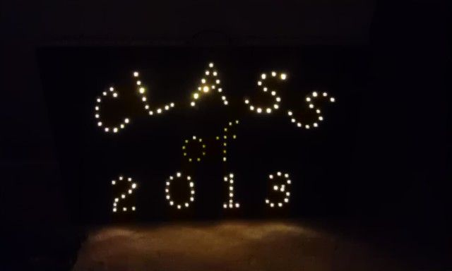

Approximately 236 LED's
Also check out my Class of 2013 LED Banner
