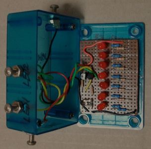

Step 2: Make the Circuit
I did not use a soldering iron. I used pliers to connect the wires.
I implement the transistor inverter/LED driver with two BC558 BJT PNP transistors, two 1.2 kohm resistors, and a bright LED.

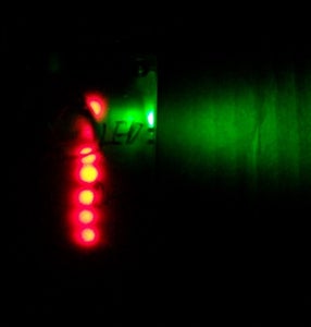

Step 3: Testing
Testing shows that the bright LED is a good light source.
You can see this circuit working on the video.
