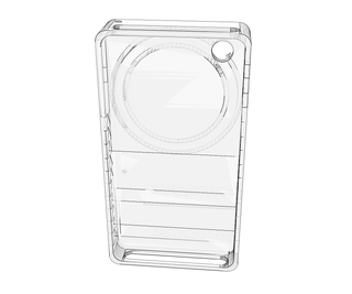

Step 1: STL Files
The first thing I did was design the case, though this is not perfect due to the scaling being off while it exported. I can provide the files in any format for you guys, just leave a comment.
Because of the scaling problem the 3d printing software has a scaling option and the dimensions (mm) L,W,H are..
Case- 65x31x120

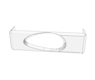

Home Button- 62x12x20
Camera- 62x12x20
* If you are within a 2mm tolerance you should be fine.

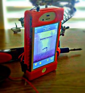

After plugging in my phone to make sure it actually works (it did), I hot glued the speaker to the left of the transistor. When you have done this glue the camera piece into place so you can slip your phone in and out. I did not glue the button piece in place as it snaps on and off.
Step 8: Finished Product!
Though this case may not protect my case very well it looks beast! I was thinking of adding a cover but you know you kinda have to show off all of your hard work. And as a side note the side railing on the volume control side fell off, it didn't effect performance. The LEDs blink and though the speaker is not perfect, you can help its output by changing the EQ of the music. Settings> Music> EQ. Have fun, add an infinity mirror, or what ever but style it to express you!
