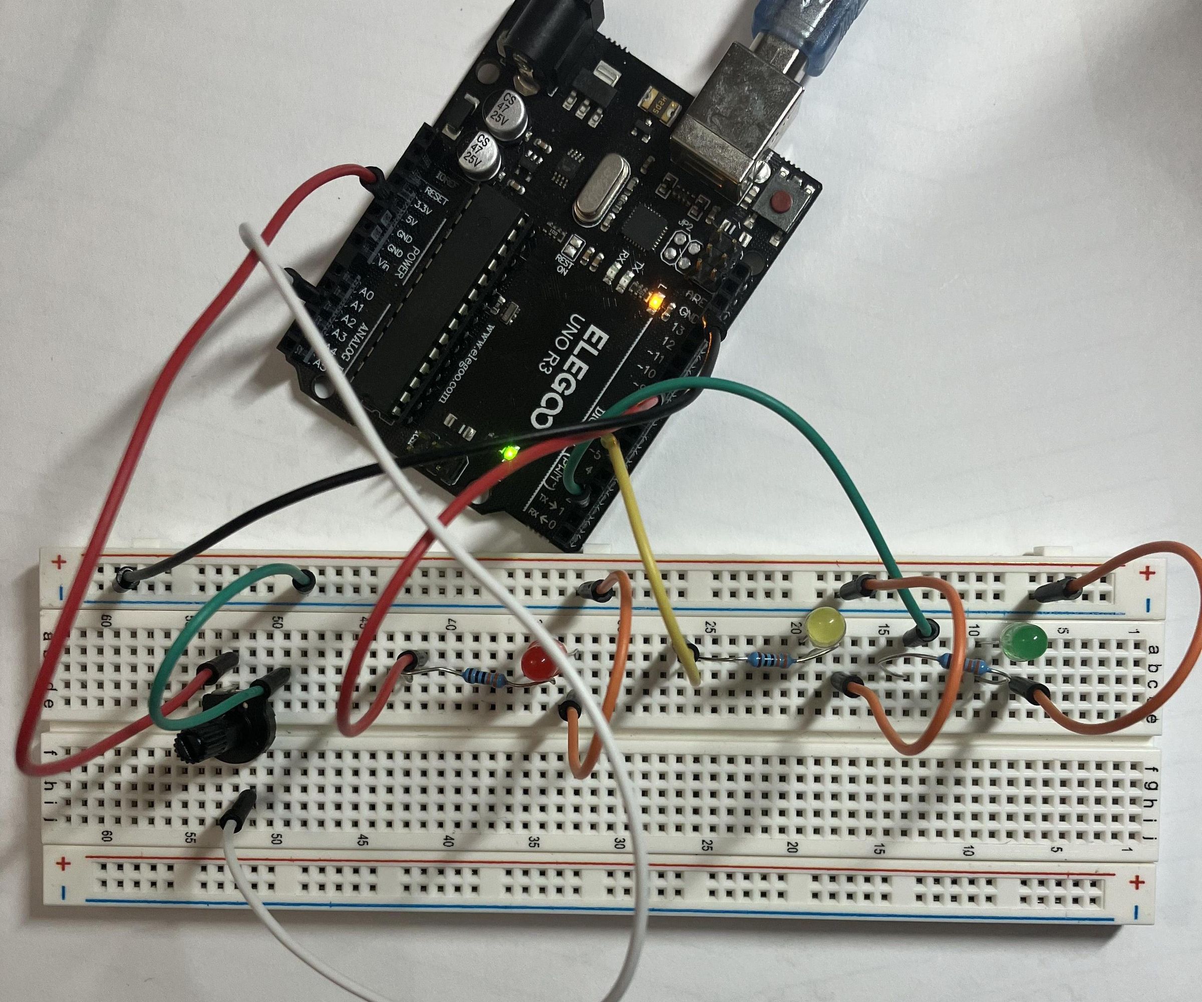

Step 1: Attach the Resistors and LEDs
Connect as shown. The bottom of the resistor should connect to the long end of the LEDs.
Step 2: Connect the Resistors to the Input Pins
Connect the top of each resistor to 4 different input pins on the microcontroller board.
Step 3: Connnect the Circuit to Ground
Connect the short end of the LEDs to ground (GND).

Step 5: Test the Circuit
The output of the LEDs should match the chart above, where the red LED represents the first digit, and the yellow LED represents the fourth digit.
