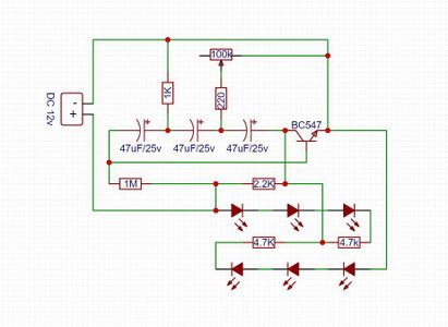

Step 4: Schematic of LED Brightness Controller Circuit
The schematic of LED brightness controller circuit along with the PCB layout can be seen above.

To make this circuit 1st we connect 4.7 KΩ resistor with 12v led light. We make series connection between these two resistors. Then connect two resistors two empty terminal with 12v LED light negative terminal.
Again we make a series connection between 1 MΩ and 2.2 KΩ resistors. Then connect these two resistors with BC-547 transistor. We connect 1 MΩ resistor with "Base" leg of transistor and connect 2.2KΩ resistor with "Collector" leg of BC-547 transistor.
We also connect LED positive terminal with series connection of resistor and connect another positive terminal with "Emitter" leg of transistor.
Step 7: Connect Capacitor With the Circuit
Now we need to connect capacitor with the circuit. We make series connection in these three capacitors. In these three capacitors, we will get only one positive terminal and one negative terminal. We connect capacitor negative terminal with "Base" leg of transistor and connect capacitor positive leg with "Collector" leg of transistor.
Step 8: Connect Volume With the Circuit
To control brightness, now we need to connect volume with the circuit. We Connect volume ground leg with capacitor negative leg and connect volume output leg with "Emitter" leg of BC-547 transistor.
Step 9: Connect DC-12v With the Circuit
For power source we are using 12v battery or 12v adapter. We connect DC-12v negative cable with "Emitter" leg of transistor and connect DC-12v positive cable with the series connection of 1 MΩ and 2.2kΩ resistor.
