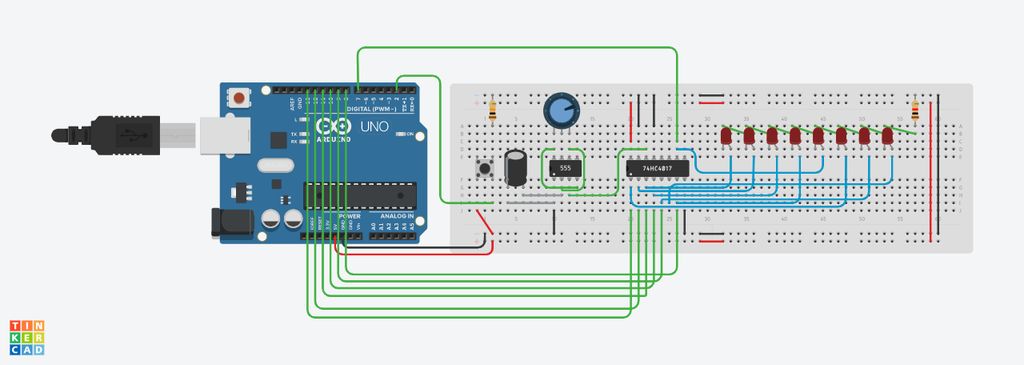

Step 1:
For the wiring, the Tinkercad and the schematic below can help with connecting all of the components together.
Step 2: Connecting the Power Source and Components
place down all the components like the image above and connect the VCC and GND to the breadboard
Step 3: Building the LED Chaser Part 1
Using the image above you will be able to make the 555 and decade counter connection. starting off connect the 555 and the decade counter to ground and Power. Then connect one of the yellow wires from CPO on decade counter to the output on the 555. Then for the other wire connect a wire to the MR to the CP1n . Then connect another wire from the CP1n to the ground. Then connect the capacitors to the ground and Power. Then connect the capacitor near the 555 to the 555 control voltage. Afterwards connect Potentiometer to power and then to the the 555 Discharge and Threshold. Finally connect the Electrolytic Capacitor to the 555 Threshold and the Ground. last add resistor to the 4 Digit Seven Segment Display
Step 4: Building the LED Chaser Part 2
connect all of the led to the resistor then connect the led to the decade counter.
Step 5: Building the LED Chaser 3
Now that the LED chaser is built, the last part of the wiring is to connect all of the Arduino Pins, and connect pushbutton as well as the 4 digit 7 segment display. Listed below are all the Arduino Connections.

In the image below, you can see where the pins are connected.
