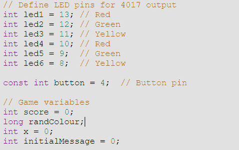

Step 4: The Code!
Let's now begin coding! The Code is a crucial step and the game itself won't even work if we don't have code, so lets start with the Variable Declaration.
led 1-6: All of the Led's in the circuit.
button: The pin connected to the push button.
score: Tracks the player's score.
randColour: Holds the random color selected by the program.
initialMessage: Ensures the welcome message displays only once.
