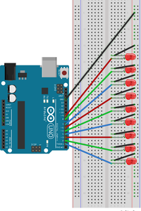

Step 2: Circuit Connection
  1. Add LED's on breadboard according to circuitdiagram connect all LED negative terminal onnegative port of breadboard
  2. I add LED in this pattern: R(red) Y(yellow) B(blue) R Y B R Y B, but you can add LED according to your choice.
  3. Connect resistors on the positive side of each LED's
  4. Connect the resistors with digital pins 1 to 9 of Arduino by jumper cables
  5. Connect ground pin of arduino with the negative side of all LED.
  6. Connect the button with digital pin 10 of Arduino
  7. Your circuit connection is completed !
