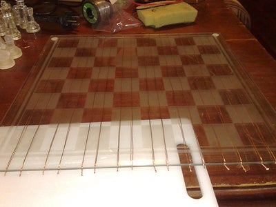

Step 2: Wrap Strands Around the Board.
I didn't, but you may want to get your wire really straight to start with. It would have been a bit better if I did.
With each of the 16 copper wire strands, fold them in half and put a kink in them. Loop the wire around the board and push the kink up to the edge.
With the wire running straight across the board twist the two ends of the wire together. Keep all of the twists at the same end of the chess board.
Use pliers to pull the wire tight and twist it up. If you twist it too tight or too much, it will break.
You want two strands of wire for each row on the chess board. Have the wire cut the square into thirds or even slightly closer.
Run the wires from one opponents side to the other. So that if you were to slide the queen from her side to the far side she would slide along two copper strands.

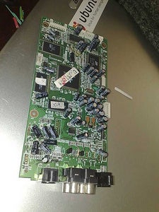

Find any old circuit board and steal some resistors out of it. They are the ones that are like long blobs on the wire with cute coloured lines around them. If you are not sure what they look like, look for images on the net, they have a pretty generic style. I got some brown, blue and green ones, but I don't know what the colours mean if anything.

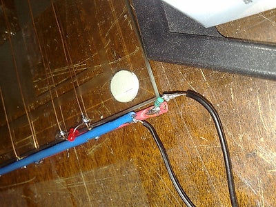

Step 5: Solder on the Rails
Lay the cable back where it was when you marked it and solder the twisted ends onto the blobs of solder that you put on the cable.
Try and keep the first cable hard up against the board on the under side of the twisted ends.
Lay the other cable on top of the twisted ends and hard up against the board. Solder it to the remaining twisted ends.
If the two ends of the cable match up, cut one about 15mm shorter than the other one and put some solder on the end again. oops. This is so that the two cables won't touch and short out. (Shorting out is where the electricity can travel from one cable to the other because they are touching with nothing good between them.)

Step 7: Adding Power and Putting in Some LEDs
Use a peg or something to hold the end of the wire from the phone charger without resistors on it to the shorter end of the cable on the board.
Plug the mobile phone charger in. Hold onto a bit of the cable that has solder on it that is attached to the charger by a peg and then use the back of a finger to touch the other wire from the charger. It really, really should not hurt you, but just in case there is something very wrong with your charger you will find out with the back of your hand and not end up gripping it and getting hurt.
Now get one of your LEDs and bend the legs out flat.
Touch the remaining mobile phone cable, the one with the resistors on it, onto the remaining cable on the board. The one without the peg on it. If it sparks or anything you have done something wrong and there is a short. If it does not spark, that does not mean there is no short though.
While the charger is connected to the board touch the LED with the bent legs two wires that go over the same row so that only one LED leg touches each wire. Each leg of the LED must only tough its own wire.
If it lights up, good. If it doesn't turn it around so that the legs touch the other wires instead. LEDs can tell if they are the right way round or not. I don't think it hurts them if they are the wrong way, they just don't light up.
Once it lights up, you know which way around it goes. Do not leave it on the board if it glows really bright and sort of a bit yellow looking. That will mean there is too much power. We will get to that.
Lay the LED on the table so you know which way around it goes. Which legs like which wires.

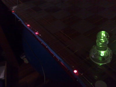

Now that you know which way around the 8 LEDs go, stick them under the wires.
They should already have their legs sticking out sideways.
Turn off the power.
Tuck a leg under each wire and then slide the LED right to the edge of the board. Make sure that each LED is in its own row. I put mine on the two ends where the castles stand and two in the middle where the king and queen go.
One colour at one end and the other colour at the other end.

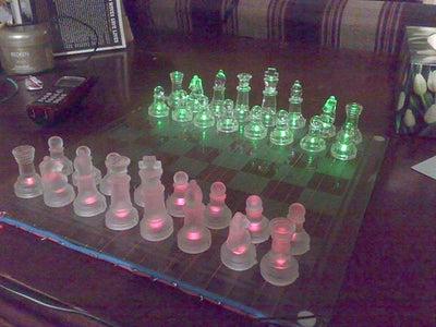

Plug the power back in and they should all be glowing. If they all glow a bit Yellow, quickly turn it off again.

THE REASON FOR THE 8 LEDS ON THE EDGE:
I first did the board with No LEDS on the edge and when all the pieces were on it was fine. But when I got down to two or three pieces on the board, they started glowing a bit yellow which is bad.
So instead of leaving some pieces on the board all the time, I put some LEDs on the edge. The amount of power used by all 32 Pieces is not like 32 times more than the amount of power used by 1 piece. It is a bit weird. 32 Pieces glow just as bright as 8. 1 Piece on its own glows really bright and wrong looking.

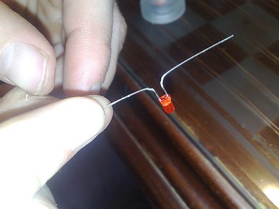

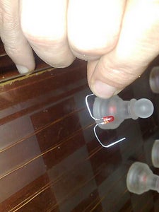

Now that you have the LEDs in the edge, you can solder them in if you like. You can also leave the board on while you do all the pieces.
Get an LED and about 3mm down from the light, bend both of the legs over at right angles. Then spread the legs out so that they make a short T
Now lay the Led on the underside of the chess piece. You may have to remove the paper bottoms from the pieces if they were ever there.
Centre the LED in the chess piece and hold the legs flat to the base. Bend the legs up the sides of the chess piece.
Take the LED off the chess piece and bend the legs in a little bit more.
Now 'clip' the LED back on the chess piece and try it on the board.
If it does not light up, turn it around. If it still does not light up, try it somewhere else, and then fix the bit of the board that is not working. I had to do this where my soldering was bad.
If the piece is facing the wrong way when it lights up, turn the LED around in it.
Made sure you set the pieces up at their own ends so that they are facing the right way when lit.

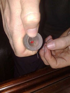

Step 11: Glueing in the LEDs
I used some crystal clear araldyte.
Mix up the areldyte, just a little. Use a match to smear it onto the chess piece and the wire that goes up the outside edge.
DO NOT put any glue on the bottom of the chess pieces. If you do get some scrape it off and when it is dry scrape it again with a knife. Metal has to touch metal for it it work.
Once you have put glue on the legs on the outside of the chess pieces, place the piece on some scrap paper and push it down a little. Make sure the legs are pretty straight.
Step 12: Finished
Once the glue is all dried, you are finished.
If the pieces don't light up for some reason it is probably because you have a piece sitting across two wires on the board that it shouldn't. This makes a short and the power goes wrong.
