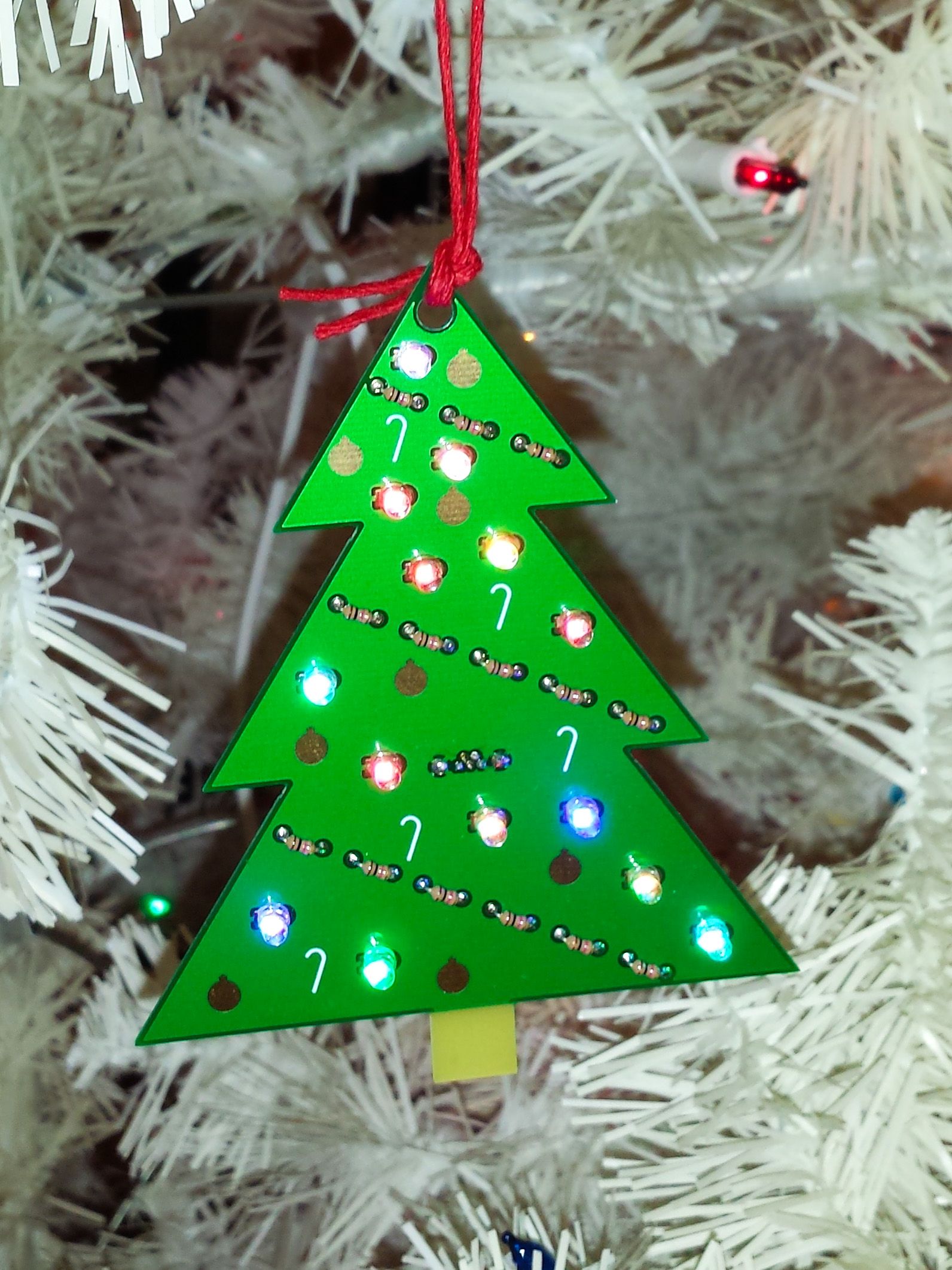

This Christmas, I decided to make Christmas ornaments to give to my friends and family. I've been learning KiCad this year, so I decided to make the ornaments out of circuit boards. I made about 20-25 of these ornaments. The ornament is a circuit board shaped like a Christmas tree. The ornament has candy canes on the silkscreen, ornaments made out of exposed copper, garlands made out of resistors, and LEDs to represent the lights on the tree. The LEDs I used slowly change color, giving the tree a bit of life. The ornament has a hole at the top for hanging it on your tree with a string. There is a Micro USB connector on the back, so that you can use an ordinary phone charger to power the LEDs.

Step 4: Solder on the Surface-mount Capacitors
On the back of the ornament, there are three pairs of surface-mount pads for attaching decoupling capacitors. I solder them like this:
- Place the soldering iron on one of the pads.
- Touch the solder to the pad, to get a nice blob of melted solder on the pad.
- With the soldering iron still in place, keeping the solder molten, use the tweezers to position the capacitor in the correct position.
- Remove the soldering iron. The capacitor should now be connected at one end.
- Solder the other end of the capacitor, so that it is fully connected.
Step 5: Tape USB Receptacle in Place
Insert the USB receptacle into the back of the board, and then use Scotch tape to hold it in place.
Step 6: Solder the USB Receptacle
Solder the USB receptacle. You need to solder the two large pins on either side, and you also need to solder two of the five small pins. (Specifically, you need to solder the pins on each end of the row of three. Although you can solder all five pins if you like.) For soldering the small pins, this is where I recommend using the thin solder and the conical tip.
Once the receptacle is soldered in place, remove the Scotch tape that was holding it in place.
Step 7: Bend the Resistors
Bend the legs of the resistor at a 90 degree angle, as close to the body as possible. You can just do this by hand; no tools are needed.
Step 8: Insert the Resistors
Insert the resistor through the front of the board. Then, on the back, bend the resistor legs to hold the resistor in place.
Step 9: Solder the Resistors
On the back of the board, solder the resistors in place.
Step 10: Trim the Legs of the Resistors
Use the flush cutters to cut off the legs of the resistors after they have been soldered.
Step 11: Insert the LEDs
Insert the LEDs and bend the legs to hold them in place. The short leg of the LED goes into the square pad, and the long leg of the LED goes into the round pad.
Step 12: Solder the LEDs
On the back of the board, solder the LEDs in place.
Step 13: Trim the Legs of the LEDs
Use the flush cutters to cut off the legs of the LEDs after they have been soldered.
Step 14: Tie the String Through the Hole in the Ornament
Cut the desired length of string, and then tie it through the hole at the top of the ornament. Your ornament is now ready to hang on your tree!
