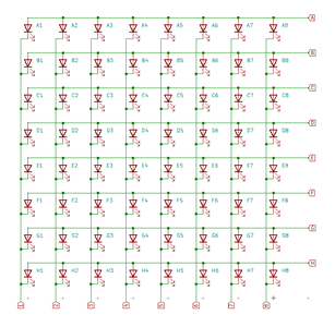

As max7219 can drive at most 64 LEDs and we have two panels therefore 32 LEDs will make a single module.
Build process for both the panels will be same.
The setup goes like this, as we 32 LEDs => 4 X 8 matrix, so the +ve of 8 each LEDs will be joined together and -ve of 4 each LEDs will be joined together (remaining 4 will come from 2nd LED module).
The process
  1. Using a template to solder and bends is very helpful. I have attached a pdf file which you print it out on A4 size paper and use it
  2. Prepare single strand wire by remove the insulation and cut out wire of length 2 x 35mm, 2 x 45mm.
  3. Bend the 45mm wire into C shape the bends be at 10mm from end points.
  4. These will act as framework for our module.
  5. Now solder LED to the wire segments with a distance of 5mm in between each LED– make sure that positive of LEDs is soldered to wire and not negative, also in case of C part they should be facing inwards.
  6. This way we have successfully connected positive of eight LEDs to each now we need to connect negative of every 4 LEDs.
  7. Cut out enameled copper wire according to dimensions given in picture - enameled is necessary as it avoids electrical connections even when both wires are toughing each other
  8. Sand out ends of each wire so we can solder them.
  9. Now this might be a confusing step as there are a lot of connections to make, I refer each LED by a specific notation do refer the picture above.
  10. Connect A1 to B1, B1 to D1, D1 to C1.
  11. Then A2 to B2, B2 to D2, D2 to C2.
  12. Then A3 to B3, B3 to D3, D3 to C3 using enameled copper wire.
Now you must have understood the pattern likewise solder every LED.
Note that in the pictures even if the wires overlap each other but they are electrically isolated.
Do create a 2nd module using same instructions.

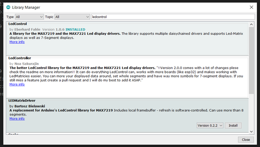

Step 9: The Code
Now that we have completed the assembly part, its time to program Arduino nano to display beautiful animations.
I used a library named LEDControl by Eberhard Fahle. Using this library, we can control individual LEDs and create our own custom animations. LEDs can be controlled by just few functions.
LEDControl lc=LEDControl(11,13,10,1);
This line initializes the communication between Arduino and max7219.

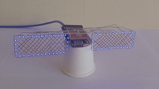

Step 10: The Done!
LED sculpture is ready!
To power, plug the USB mini b to a 5v wall adapter or even to a computer as power consumptions are below maximum rating of a computer.
