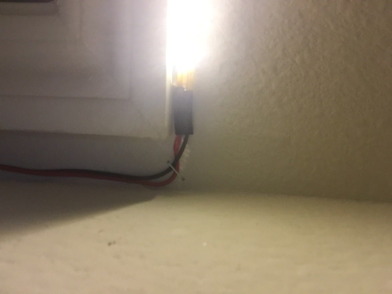

Its a simple LED light strip mounted around the inside of the door frame, all the way around, pointing in towards the closet to provide front illumination. It’s much more evenly distributed than a top down lighting system where you have a bright top shelf and dark floors. It’s got a simple magnetic switch that is operated when the door is opened or closed and it can be attached to a simple dimmer to control how bright the light levels are. The system can be run from an LED driver plugged into a wall outlet, connected to a 12v battery if an outlet is not available, or run up into the ceiling to connect to a normal socket (which I dont have in my closets but you can use if you want to retrofit an existing closet light).

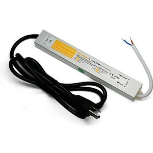

30W LED Supply Driver
The LED Supply Driver is what converts your house 120V system to the 12V required to use LED light strips. These drivers come in all shapes and sizes, but the 30W driver provides enough power for a whole closet full of lights without being overkill. It’s fairly bulky, about 2″W x 1″H x 12″L, so make sure you have some place to mount it. Mine is underneath my kitchen cabinets.

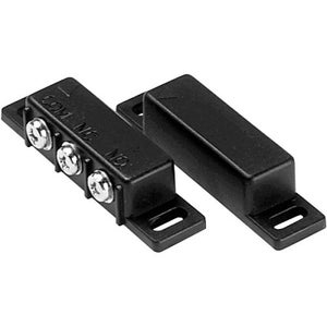

Magnetic Switch
The Magnetic Switch is what you will stick to both the door and the door frame, very close together, and that will allow the door to control whether or not power flows to the LED lights. If you don’t use this, you will either need to install some kind of light switch or be ok with the lights being on all the time. (kind of wasteful)

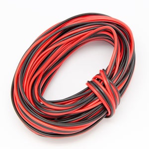

Wire. I normally use standard 16 ga speaker wire for my LED projects, but if you don’t have some, grab some from this link

There are two wires, black and red, that flow through every part in the build. We start at the wall outlet under the kitchen cabinets, flow through the LED driver to convert to 12V power, go through a small hole in the wall, down the inside of the closet, the red wire goes through the magnetic switch, and then meets up with the black wire at the dimmer. The dimmer outlet then connects to a new set of wires that runs to the LED strip, which then runs all the way around the door.
Once you physically place the components, stick them in place with some double sided tape (the LED’s should have sticky tape on the back already) and begin laying out your wire. I used a light duty upholstry staple gun to make my wires run straight and sit tight against the wall and this keeps them from looking unfinished and droopy.
