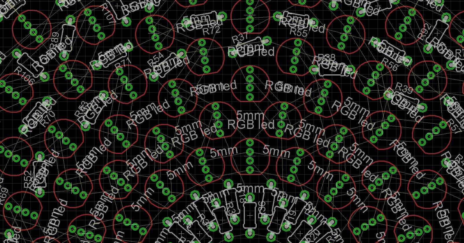

Everything fits on a single sided PCB. Find here the Eagle and Gerber files so you can make it yourself or ask a PCB manufactorer.
I use the LED Compass and Altimeter in my car and use the OBD2 interface as a power supply. The microcontroller fits perfect in the connector.
Step 4: How to Perfectly Align LED's in a Circle in Seconds With Eagle PCB Design Software
You must see this really nice feature in Eagle PCB Design Software which saves you hours of work. With this Eagle feature you can perfectly align LEDs in a circle in seconds.
Just click on the "File" tab and then "Run ULP". From here click on "cmd-draw.ulp". Select "Move", "degree step" and "Circle". Fill in the name of the first LED in the field "name". Set the coordinates of the center of the circle on the grid at the fields "X center coord" and "Y center coord". In this project are 48 LEDs so 360 divided by 48 makes 7.5 for field "Angle step". The radius of this circle is 1.4 inch. Hit enter and you have a perfect circle of LEDs.
