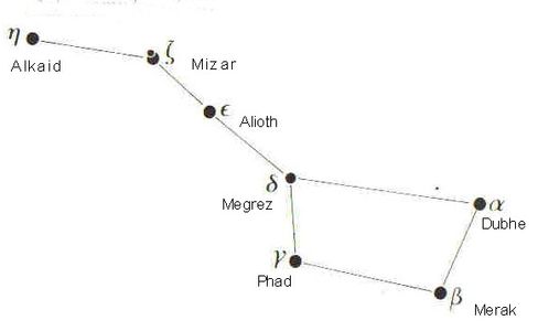

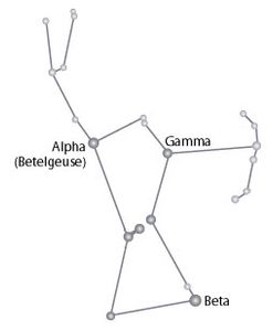

Choose a constellation and print a photograph of the stars in the system. In this tutorial, we used both Orien and The Big Dipper. The best way to find a good image is to use google image search to search "your constellation + drawing."

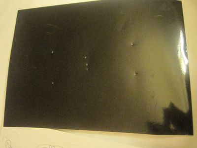

Once you have found a good drawing of the constellation, print the drawing and place it over a sheet of black poster board or paper. Use a ballpoint pen firmly press through the top layer to make dots on the black poster paper beneath, which you'll use later to indicate where the LED's (stars) should be placed.

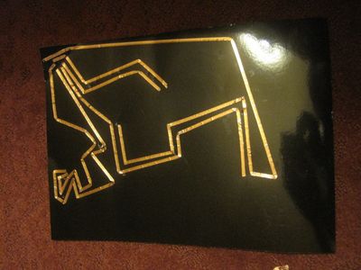

The next step is to plan the Chibitronics circuit. Using a pen draw the positive and negative sides of the circuit so that all of the stars can connect to the battery.
Next, determine the battery placement by folding the corner of your poster board over the 3V coin cell battery. Once you have your battery placement, mark the battery so that you know where to terminate your circuit. Be sure to remember the polarity of the battery.
If you're using an effects sticker, be sure to create a place for if first, as it will likely impact how the circuit is designed. Placing the effect sticker close to the battery is recommended. Be sure to mark each corner of the effects sticker properly, as it makes drawing the remaining circuit more challenging.

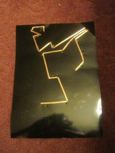

Once you have your battery and LED (and effects sticker if applicable) placements you can design the rest of your circuit. Remember that the Chibitronics conductive tape is about 1/8 of an inch (3mm) thick and that you'll want to leave 1/8 (3mm) between the positive and negative part of your circuit.
Step 3: Laying the Conductive Tape
Starting at the battery, apply the conductive tape that will carry electricity to the LED stickers (and effects sticker if applicable). The positive and neutral "sides" of the circuit should not touch. Remember, the paper will "fold" over the battery to close the circuit. Note the polarity of the battery when creating the circuit. You will need to know which side of the circuit is the negative and positive when applying the LED stickers in step 4.2. Note: You should not attempt to "join" the conductive tape. If your tape breaks, remove it and start over. Attempting to join the tape will lead to unreliable conductivity and may mean an inoperable circuit.
