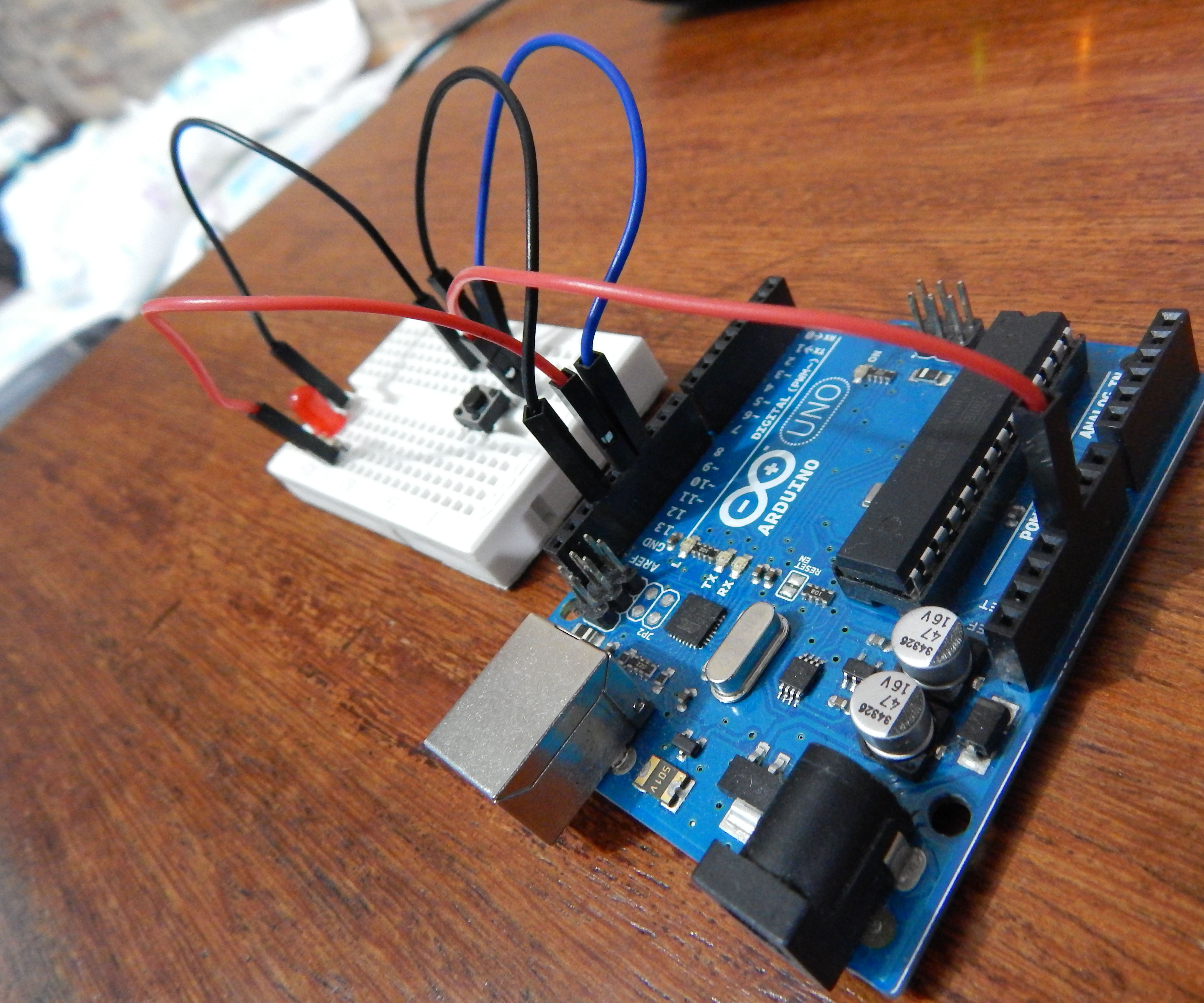

Setting up:
1ª Connect the HC-06 module (See Pict.):
Arduino-------------HC-06
RX-------------------TXD
TX-------------------RXD
+5V-----------------VCC
GND----------------GND

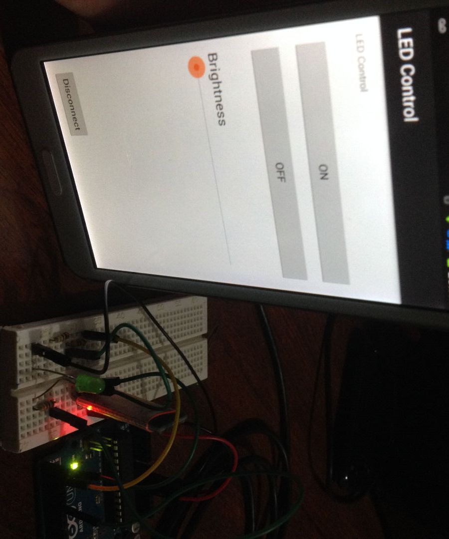

Step 2: UnWired Lite and Pro
unWired is an spp aplication that connects to arduino’s bluetooth modules and plot realtime data. You can try this one or other you’ve already known.
Before running the apk, pair the bluetooth module.
The first screen of the apk is shown in Pict. 01, click at ‘Paired Devices’. It’ll list all the paired devices, then you selected the bluetooth module you’ve paired before.
The second screen (Pict. 02) is where you write the commands to send to bluetooth. The commands are LO for Led On, and LF for Led Off.
You can download unWired Pro if you want to plot realtime data.
Done!
Now you know how to set up bluetooth modules to arduino and send commands to it.
