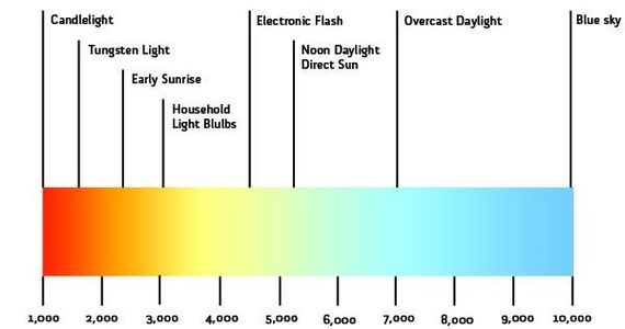

I think the most important thing for me was to look at was the color of the LED. When it comes to lighting there is something called color temperature, typically people will call a light warm or cool depending on the temperature of the light. Colder color temperatures tend to be more blue, while warmer colors tend to be more yellow. To make this more confusing, color temperature is measured in Kelvin, with cooler colors having a higher value than warmer colors. For example the strip I have has both a warm and cool while LED, the warm white is noted as 2700k and the cool white is 6500k. I’ve included a chart to help give you a better idea of what temperature corresponds to what k value. RGB LEDs tend to have a very cold white so for me it was important to get a strip that either had an additional LED that was a white, and specifically a warm white. These are generally called RGBW strips, this can either mean they have 2 LEDs at every location, one RGB LED and one white LED, or I found some strips that have what they call a 3+1 LED or a single LED that has red, green, blue, and white in one.
