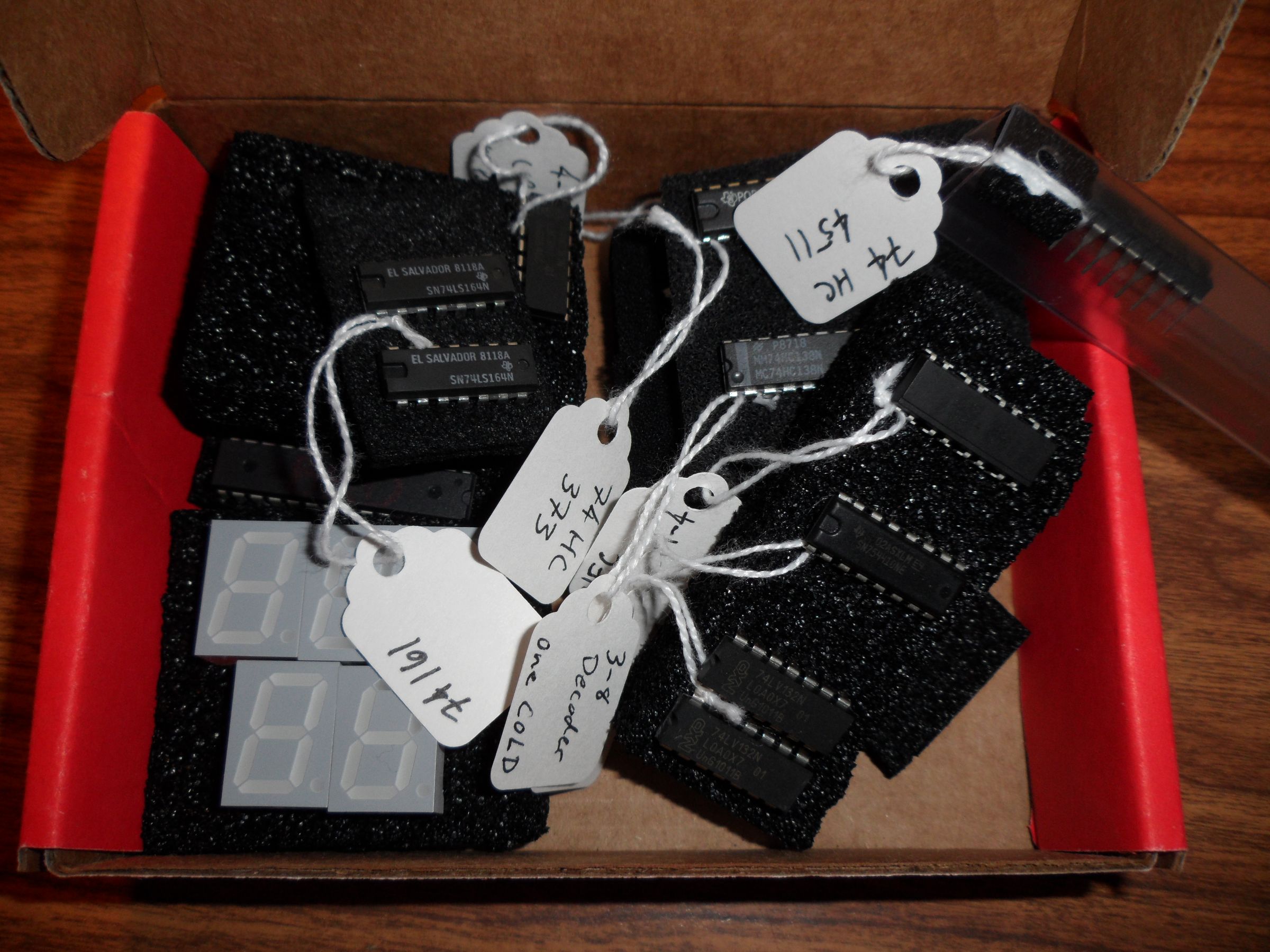

My design uses 5 x 3-8 line decoders (also known as DEMUX) to convert a 5-bit parallel binary output to a one-hot 25-bit parallel output, which drives the columns of LEDs. "One-Hot" means that only one of the 25 output pins will be "hot" at any given moment. If the five output pins of the arduino are: 01010, this is the number 10 in binary. The decoders take interpret this signal and in turn power on output pin number 10 of the 25 columns (numbered 0-24). See the attached design for illustration.
As many other LED cubes do, my design also uses NPN transistors to switch the cathodes of each plane of the cube.
My design also includes a custom designed Printed Circuit Board, to eliminate the many unsightly wires that would otherwise be needed.

Second Thoughts: Be sure to get one-HOT decoders, many will have every output high, but the one selected output LOW. This is the opposite of what we want here. Be CERTAIN to check the truth table in the data sheet of whatever chip you purchase.
