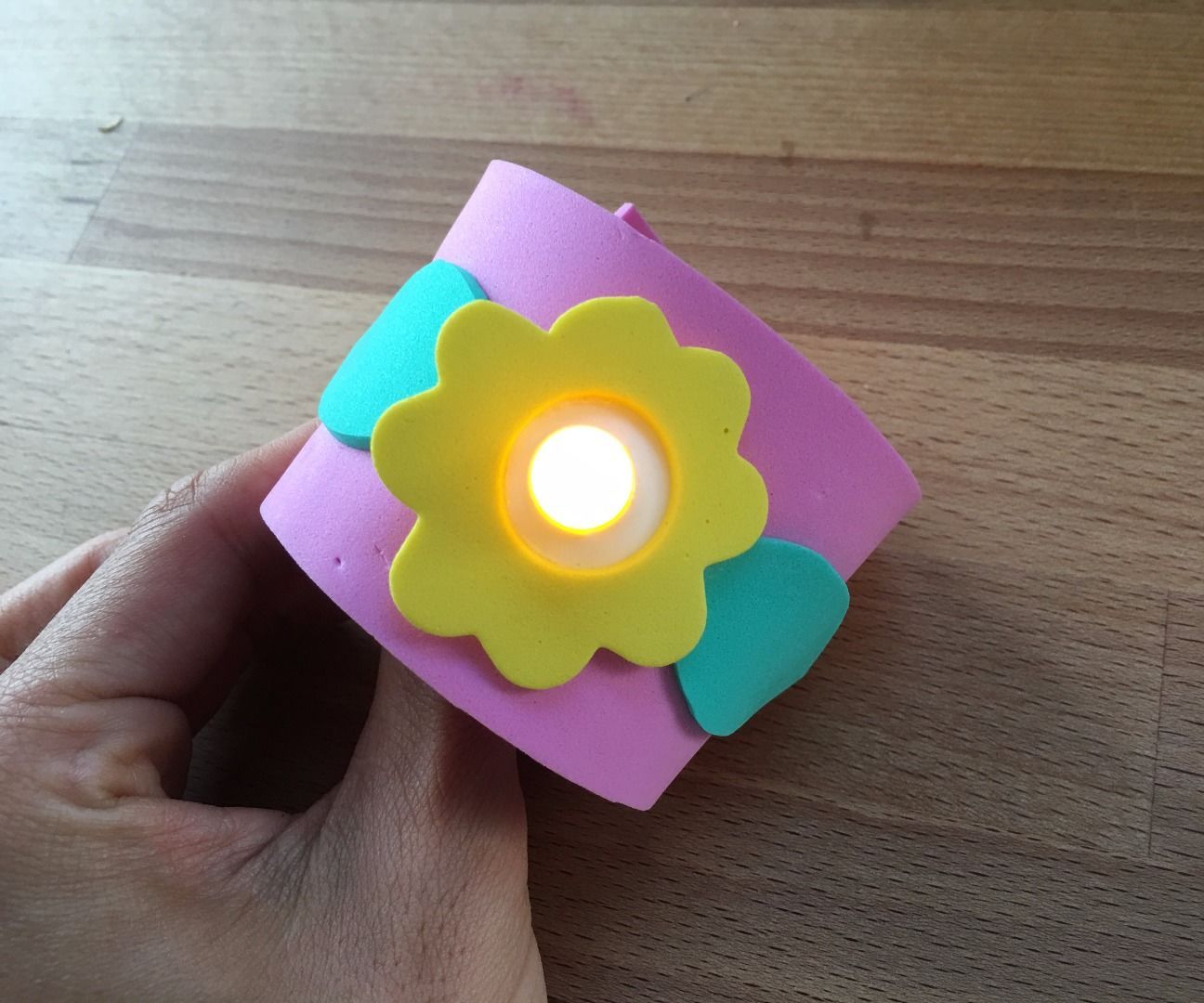

Introduction: LED Cuff (Advanced)
Make a the advanced version of the wearable LED cuff! This cuff allows for multiple LEDs and requires some basic sewing know-how. Recommended for ages 12 and up.
