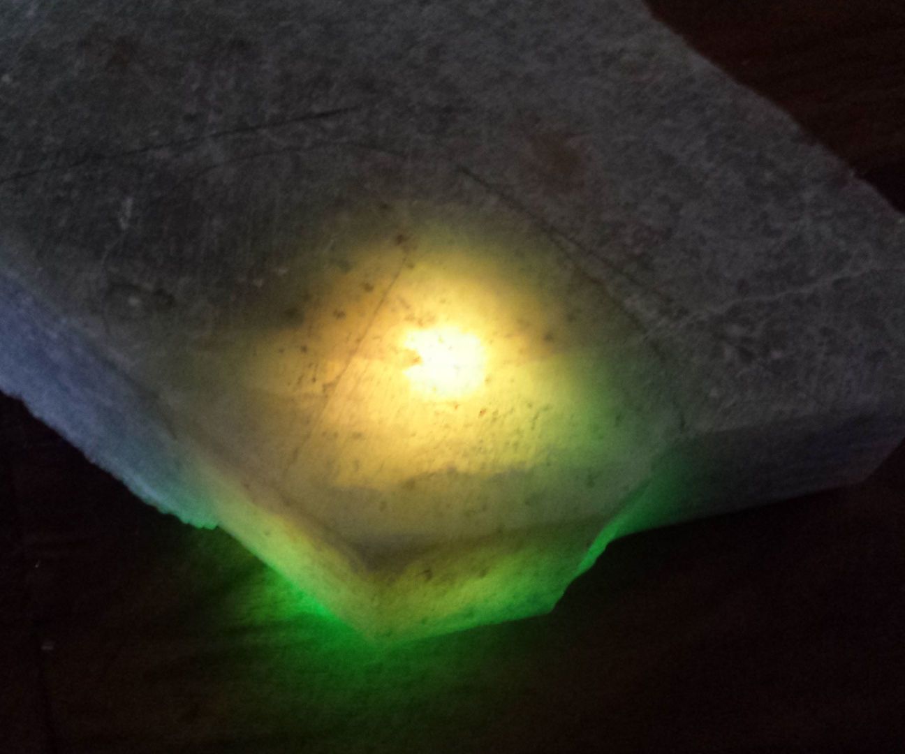

Step 2: Freeze Time
Gently move your water filled mold to the freezer. You can use distilled water or a splash of salt, (bubbling) for clearer ice.
Place weighted go pro or clear plastic cube within the mold to create the LED enclosure.
Step 3: Gently Remove Rubber Mold... Free the Ice!
Now that the ice mold is frozen. Gently work your fingers in between the rubber mold & ice casting until the ice creation is free from the rubber mold.
Step 4: Place LED & Enjoy the Glow!
Place the LED cocktail light in the pre-frozen enclosure & sit back to enjoy!
