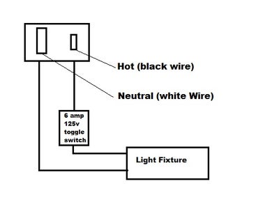

The wood you use should be somewhat heavy to provide a nice solid base for the fixture. I had some 1" MDF left over from a project that worked out fine. I used a router to cut a circle out of it and decided to give the top edge a rounded over profile while I still had the router out and ready. You can use many different tools to cut a circle out of wood from a table saw to a jig saw its really up to you. I used a drill to make the power cord hole in from the side and down from the top being careful not to go completely through. I also used a drill to mount the 6 amp 125ac volt toggle switch on the base. As far as the wiring goes its just a matter of connecting them as shown in the diagram.
