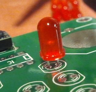

Step 2: Installing LEDs
This device comes with seven LEDs. This is the focal point of the project, so we want it to look nice. Using a small piece of masking tape, you can hold the LED to the board. Otherwise, when the board is flipped over to solder, the LED is going to lean in to an unpleasing angle. After the LED is soldered in place, the extra leads can be removed.
The LEDs do have polarity, and CAN be installed wrong. If you look closely, the footprint of the LED is not a prefect circle. There is a flat side on the negative lead. You will also see the positive lead is longer. Take care to align the flat side of the diode's footprint with the flat side of the screenprinted footprint on the board. All of the LEDs do not point the same way. Check the polarity of each LED before soldering it in place.
