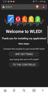

Follow the instruction to upload the firmware. If all goes well you should be able to connect to the ESP8266 access point called WLED-AP and the default password is “wled1234” or you can scan the following QR code on your phone.
This should brings you the http://4.3.2.1 in your browser, where you can configure the WiFi, or just test the lights effect. You should be greeted with the second picture Welcome to WLED screen.
If you click the “TO THE CONTROLS!” button you should be able to play with the feature of the WLED as shown in the next image above, with pretty rainbow colours.

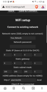

You can proceed to click on the “Config” or you can select “WIFI SETTINGS” on the first screen which will take you the next screen which shows the WiFi setup.
It allows you to enter your Network SSID and password to connect to your home router so that you can control it from anywhere at home. It is worth noting that WLED supports HomeAssistant, so if you have it, then it can come handy. If you are not sure what HomeAssistant is, you can find out more in my blog on How to Install HomeAssistant into Raspberry Pi.
