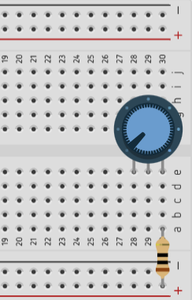

Step 1: Add Potentiometer
Place the potentiometer on the breadboard as shown above.
  1. First pin on e28
  2. Middle on e29
  3. Final on e30
The first pin is Terminal One, second is Wiper, and the final one is Teminal Three.

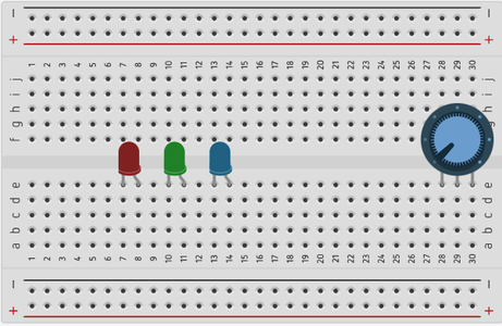

Step 2: Add LEDs
Add the LEDs as shown above.
The longer leg is the anode, while the shorter is the cathode.
  • For the first LED: Cathode on e7 and Anode on e8.
  • Second: Cathode on e10 and Anode on e11.
  • Third and final LED: Cathode on e13 and Anode on e14.
The LEDs can be different colors of you want them to look better!
Step 3: Add Resistor
Add the 10Ω resistor.
  • One leg on a30.
  • The second on the positive rail, usually marked with a '+'.(It does not matter where on the rail)
Step 4: Wire Everything Up
Add wires using the image above, or follow these steps:
  1. a7 to negative rail, usually marked with a '-'
  2. a10 to negative rail
  3. a13 to negative rail
Terminal one of the potentiometer is on e28, the wiper(middle) on e29, and terminal two(third pin) on e30.
  1. b8 to b29
  2. c11 to c29
  3. d14 to d29
  4. a28 to negative rail

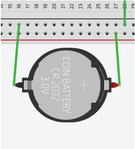

Step 5: Attach Battery
Connect the positive terminal to the positive rail and negative terminal to the negative rail.
Step 6: We're Done!
Above: potentiometer at a dimmer setting
Turn the potentiometer to change the brightness of the LEDs.
This can be done with any number of LEDs as long as you follow these rules:
  • Terminal 2 (potentiometer) to positive rail
  • Wiper to anodes (LEDs)
  • Terminal one to negative rail
  • Cathodes (LEDs) to negative rail
