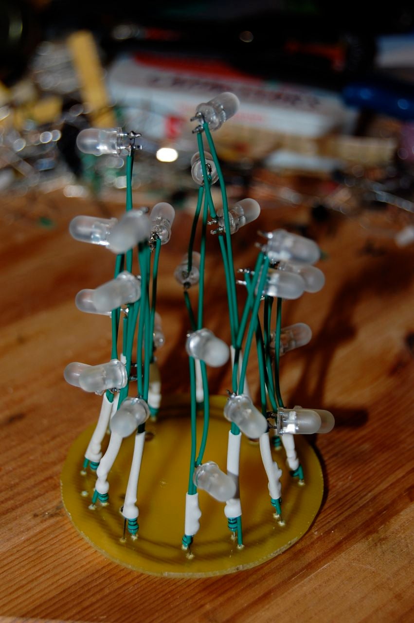

Step 3: Make the LED Branches

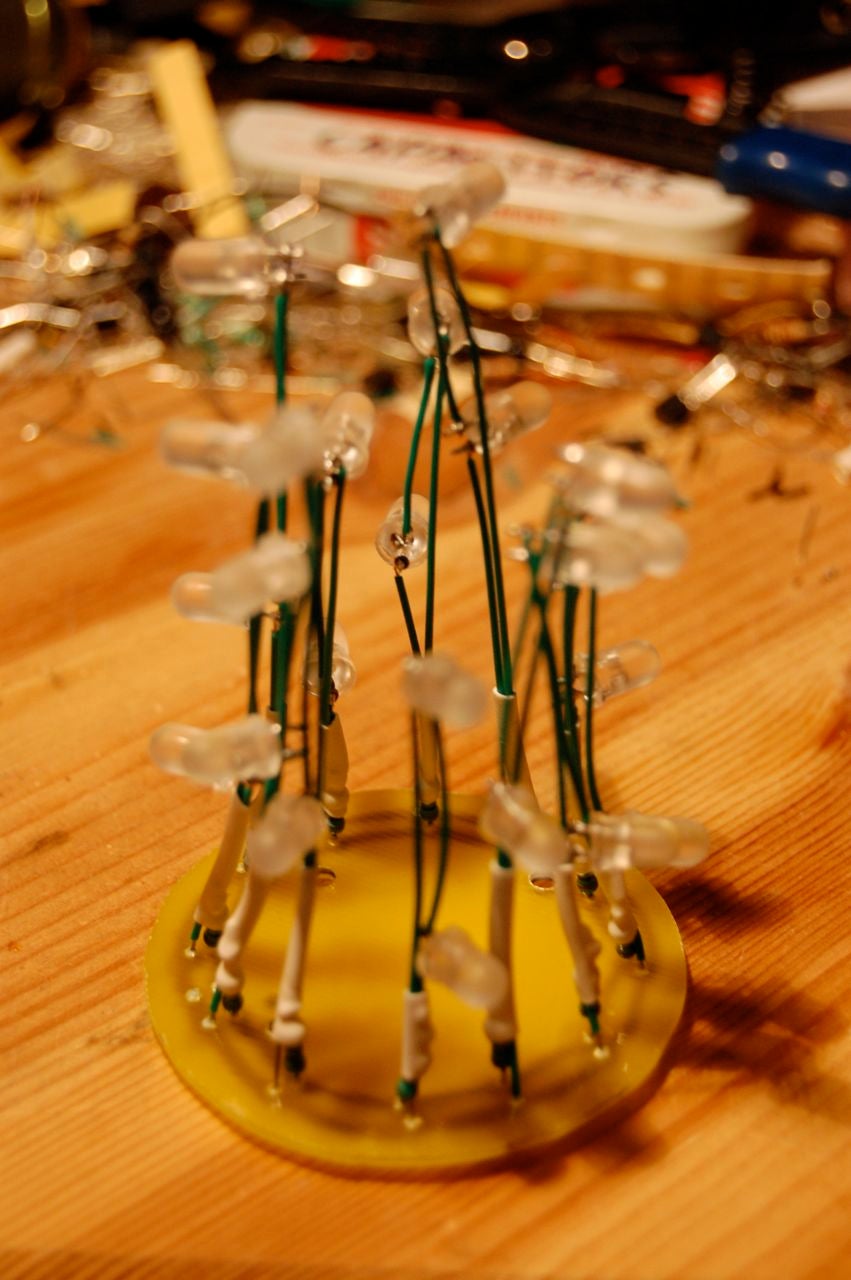

My LED Disco Light used 24 RGB LEDs. Yours may use more or less, depending on the size of the jar you've got. The 24 LEDs are arranged in 12 branches, each comprised of a single current-limiting resistor and two LEDs, all connected in series. Each LED receives about 3V, as dictated by the LED's datasheet. Don't exceed this value!
Those 12 branches are then connected in parallel with each other, so that each branch receives about 6V (3V + 3V + a nominal amount across the resistor).
You may want to start by "frosting" each LED using a piece of 800-grit sandpaper to diffuse the light a bit.
I spaced the LEDs in each branch at a random distance, so that when they were place in the jar they would appear randomly placed. Try to make a wide range of branches, but also make sure they will fit inside the jar!
The assembly is relatively straightforward. Start with the resistor, twisting a bit of wire around one lead and soldering it down. This is where the "helping hands" clamp comes in handy; the pieces tend to move around! Then solder an LED to the other end of that wire. Solder another wire, then the second LED. Finally, solder on the last wire so that it reaches all the way back to the resistor.
To anyone who has played with LEDs this will seem obvious, but to beginners remember this: OBSERVE POLARITY! LEDs will only light if connected in the right direction, and while nothing will blow up if you hook them up backwards they certainly won't light and you'll be sad. The LEDs have a longer lead (positive) and a shorter lead(negative); when I made my Disco Light I made sure that the long lead was towards the resistor on every branch.

Step 4: Finish the Branches
You should now have a number of branches (in my case, 12). On each one, place a short piece of heat shrink over the resistor. This helps keeps the wires together and makes testing and assembly easier. Shrink the heat shrink with a heat gun or a lighter. If you use a lighter, be careful not to scorch anything!

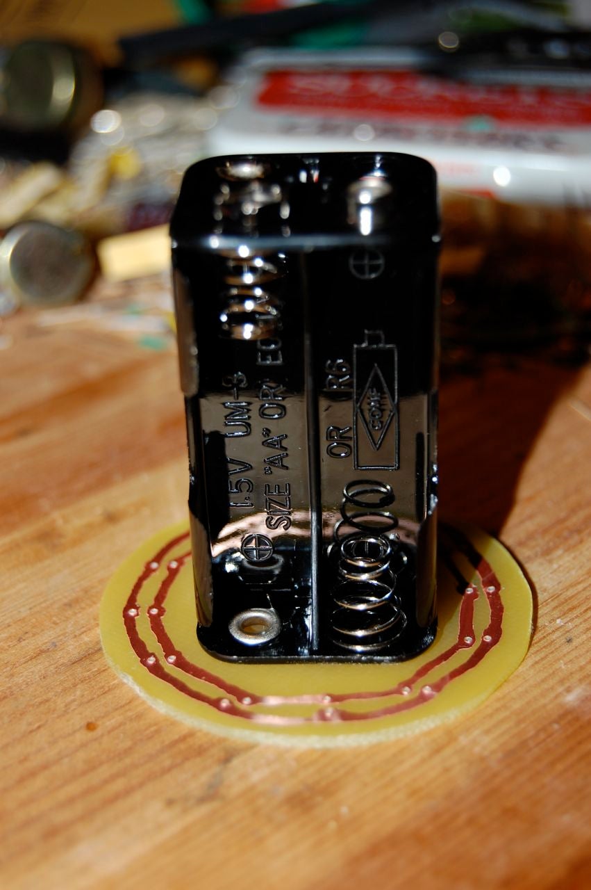

If you're lucky enough to have a PC board etching setup, this part will be easy.
Instructions if you are using a PC Board:
1. Cut out a piece of copper-clad board that will fit inside the neck of the jar.
2. Using an etch-resist pen (or in my case, a bottle of nail polish my wife didn't want anymore) draw two concentric circles around the outside edge of the PC board. Make sure there is enough room in the center to mount the battery holder!
3. Etch the board
4. Drill 1/32" holes in the tracks at regular intervals around the board, one pair of holes for each branch, and an additional set of holes for the battery/switch.
5. Drill three more holes approximately as shown, for mounting the standoffs and to pass a wire through the board.

Step 8: Solder the Branches Onto the PC Board
Here's the fun/tricky part. Solder each branch onto the PC board, again observing polarity. You may want to mark each circle as the "positive" and "negative" rail beforehand, so you don't end up soldering a branch in reverse. Try to alternate the branches so you don't have any LED directly beside another.
If you're using perfboard, glue the branches in place first, then solder the "rails" in two circles around the board to connect the branches.
Once all the branches are soldered in, you can hot glue the battery holder in the middle. Make sure it doesn't cover any of the drilled holes.

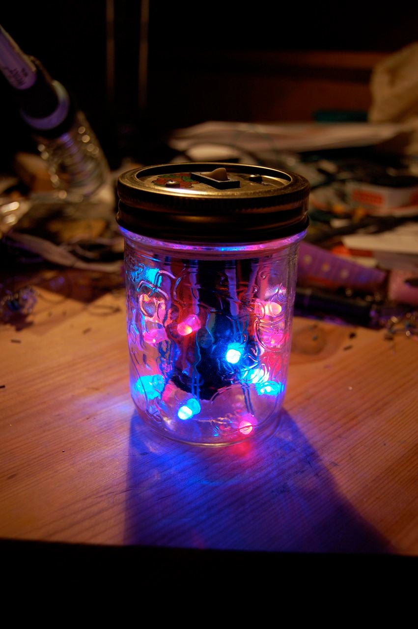

Load up some batteries, and switch it on! It should light up now.

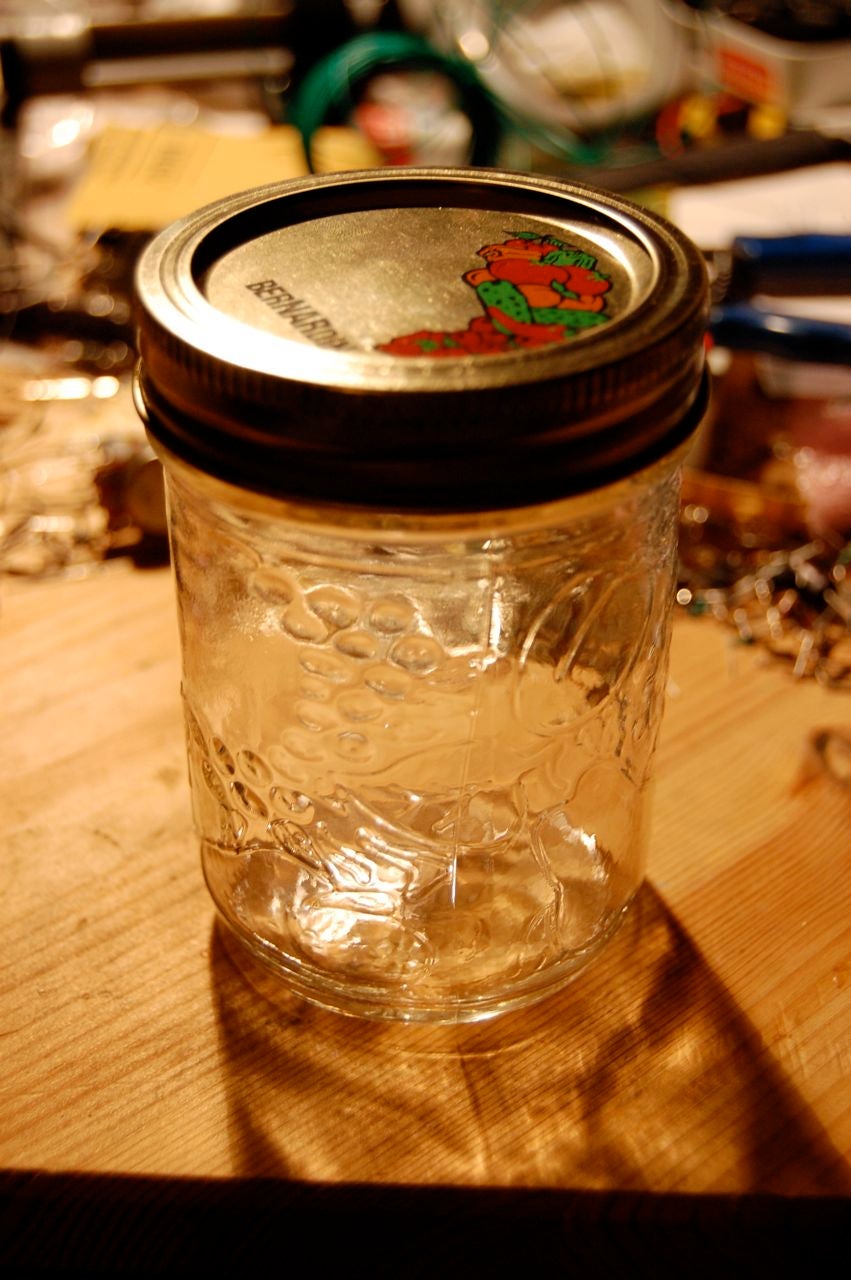

Step 10: Final Assembly

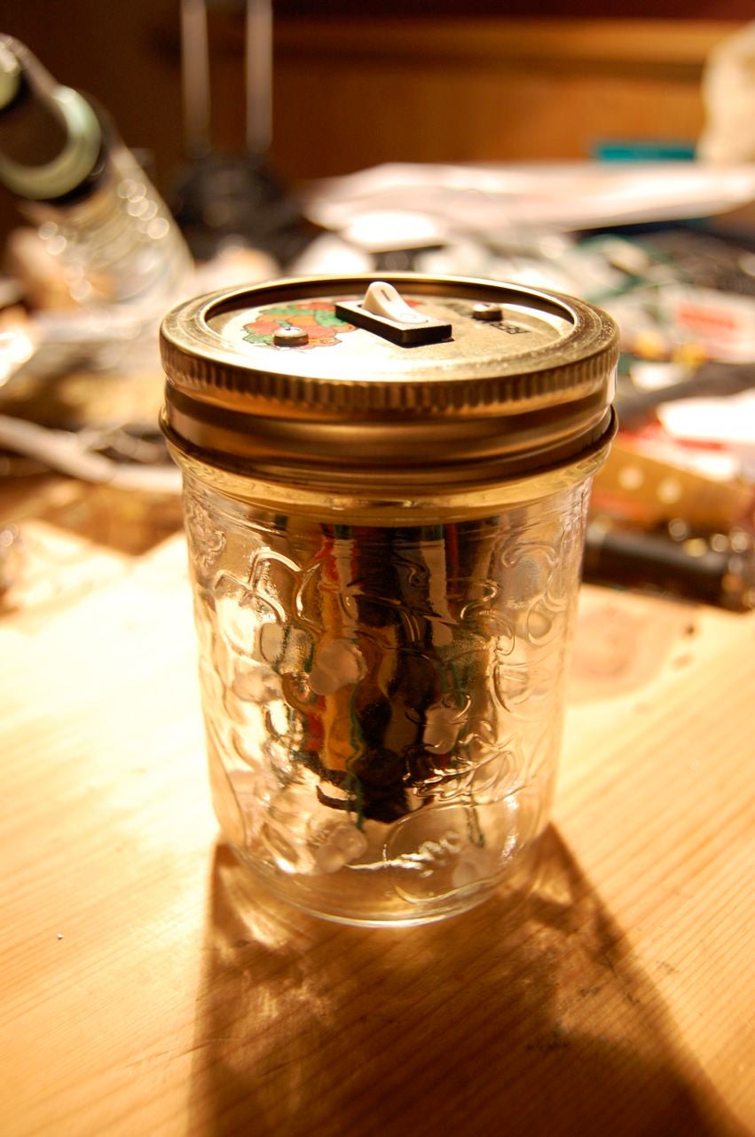

Now just drop the completed light array into the jar, and tighten the lid. Go ahead, turn it on and make sure it's still working!
Oooooh, shiny!

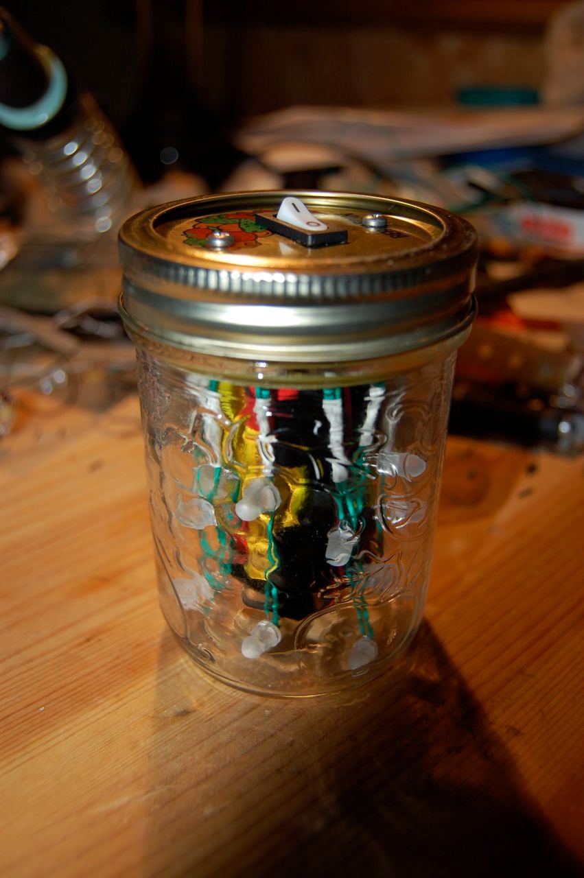

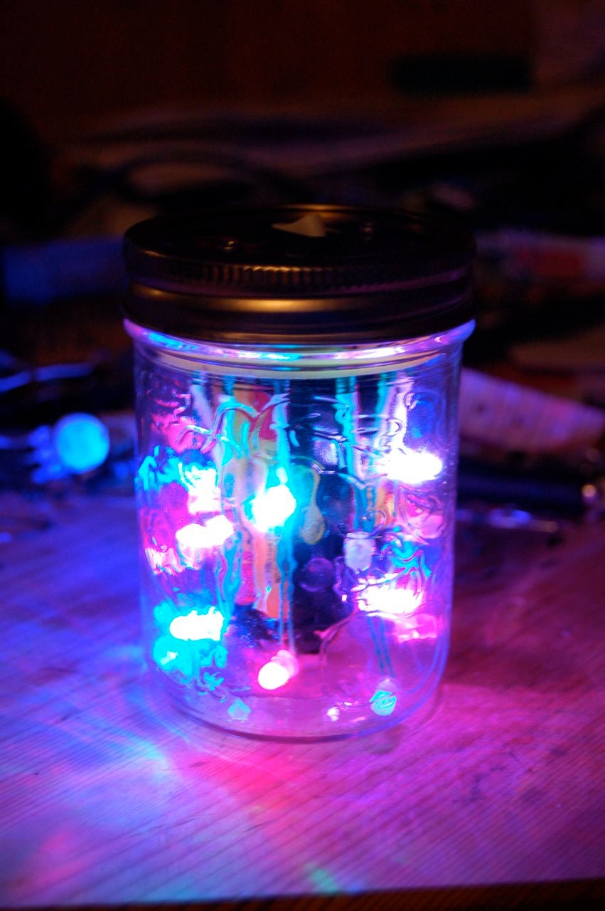

If you like seeing the LEDs through the glass, then consider this project done. However, if you've prefer a bit of mystery, you can frost the glass using glass frosting spray or glass etching cream. I used Rustoleum glass frosting spray. Frosting the inside of the jar hides the mechanics of the Disco Light, and helps diffuse the light a bit.
Spraying the inside of the jar is messy. Protect the outside using masking tape, and spray a coat inside the jar every few minutes as per the directions on the can. You'll probably find that the frosting spray isn't drying very quickly - I used a heat gun to dry the frosting inside in no time. It will take a few coats to hide the innards. Using white wires and painting the battery holder white will further obscure the contents of the jar.
