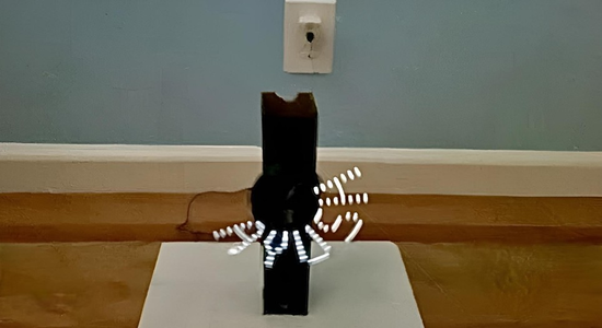

This is an LED fan that uses the concept of Persistence of Vision (POV) to display text when spinning. POV is an illusion where the eye's perception of a lit object remains for a very small amount of time after it has disappeared, causing it to appear as if the object is still there.
Don't believe that this exists? The "Ayush" in the second image was created using a single line of LEDs, yet it manages to appear as 2-dimensional letters through POV.
The fan comprises of a 3D-printed fan blade containing a 9V battery-powered Arduino circuit that creates the illusion of text by flashing LED lights at different angles when spinning using a small DC motor.
I decided to begin this project after discovering a similar project completed by Electronoobs on YouTube, as well as a similar project completed by Scott Mitchell on Instructables, both of whom I referenced during my process.
You can find a link to my demo here! The YouTube version of the video seems to run at a lower frame rate than my phone, so unfortunately the letters are a bit difficult to discern.

Obviously, it is important to test one's parts after every step, but this step is the final test to see if everything works together as intended.
I had to make sure to test the location of the words to make sure that they are at a readable angle, test that the fan blade spins at a reasonable speed, test how different words and letters look, test the stability of the build, etc.
If everything works as intended, then the base project is complete!
If not, then I would need to go back to some of the previous steps and try to double-check my actions.
Step 8: Finishing Touches!
As some finishing touches, I painted my structure black to make it look neater, and I also replaced my base with a heavier, more visually appealing base to maximize structural integrity.
There are countless other stylistic or structural changes that someone can make to customize their own POV Display Fan, these are just the options that I chose to do for mine. Do what suits you best!
And with that, I fully completed my own POV Display Fan, all you need to do to activate it is to flip on the slide switch on the fan blade, flip on the switch on the power jack, and give the fan a little push in the right direction to get it started (this is because the motor may not have enough power to activate the spinning, but it has enough to maintain it).
