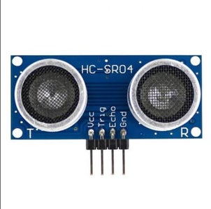

Ultrasonic Sensor (HC-SR04):
  1. Trigger Pin: Initiates the measurement process by sending out a short pulse.
  2. Echo Pin: Receives the reflected pulse and calculates the distance based on the time taken for the echo to return.
  3. The sensor operates by sending a sound wave, measuring how long it takes for the wave to reflect off the object, and calculating the distance based on that time.

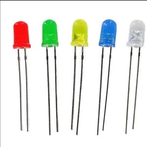

LED:
  1. The LED acts as an output to display the distance measured by the ultrasonic sensor. Using Pulse Width Modulation (PWM), the LED brightness is varied depending on the distance detected
  2. As the distance decreases, the LED brightness increases, providing a visual cue about the proximity of an object.

• Add LED and resistor according to circuit diagram .
• keep common all the negative terminal of all 5 LED's.
• Connect resistors with the positive terminal of this LED's.
• Now take arduino and connect pin no. 4,5,6,7 & 8 with second terminal of this resistors.
• Now connect the ground pin of arduino with the ground negative terminal of LED's.
• Now take ultrasonic sensor HCSR-04 and connect it's VCC to 5V pin of arduino and it's GND pin with arduino GND pin.
• finally connect the Trigger pin of ultrasonic sensor with pin no. 2 of arduino and echo pin of ultrasonic sensor with pin no. 3 of arduino.
