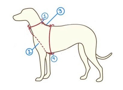

Measure out desired dog or pet. You will need to (1) measure around neck to get a collar length, (2) measure from collar/neck region to under portion of the chest, (3) measure from collar/neck to back area, and (4) measure around chest. Refer to the chart above to see where each measurement is taken. The measurements will be referred to as the names below:
(1) = collar piece
(2) = chest strip
(3) = back strip
(4) = belly piece
