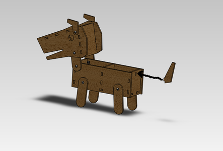

A few days later, after a bit of time on SolidWorks, I designed an inspiring and friendly companion in order to begin my efforts to spruce up my desk; plus, it doubles as a much more interesting container for office supplies and as a new lamp. I named my new friend, Spotlight, it is a pose-able, dog-shaped lamp and desk organizer.
This Instructable will show you how to make your very own Doggy Lamp/Desk Organizer to keep you company in the early morning hours as you complete your homework or latest DIY project. Or, since the holidays are approaching, you could make a Doggy Lamp/Desk Organizer as a gift for your favorite desk-lurker.

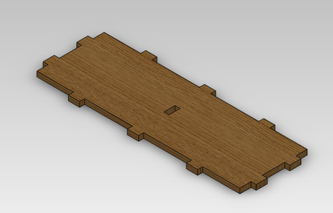

The majority of the Doggy Lamp/Desk Organizer is built from laser-cut MDF. I used Ponoko for the laser cutting since I unfortunately do not have a laser cutter. I have made the design files for the Doggy Lamp available for free in my Ponoko Showroom. You are welcome to use the design files to order your own Doggy Lamp parts or you can modify the design. Be careful modifying the design too much though because, as you will see in later steps, the pieces of the Doggy Lamp fit together with tabs so you want to be cautious not to mess up the alignment of the tabs. As for a material, I used double sided white-oak veneer MDF.
If you have access to SolidWorks 2011, I have also attached an assembly file of the Doggy Lamp to this step.
The design file on Ponoko also includes the electrical components needed for the LED Doggy Lamp/Desk Organizer.

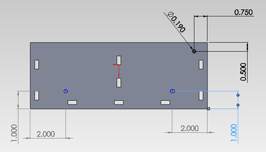

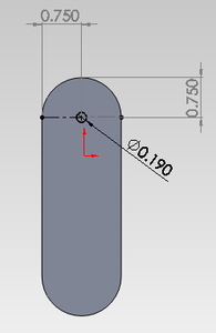

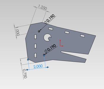

Step 2: Drill Holes for the Bolts
I chose not to have the holes necessary for connecting the pieces of the Doggy Lamp cut by Ponoko in order to limit the cost of the order. It is far cheaper simply to drill holes manually than have a laser cutter do it. Plus, in case you have some spare nuts and bolts in your shop, you can drill any sized hole you need.
Holes will need to be drilled in the leg pieces, neck pieces, head pieces, body side panels, and ear pieces. Take a look at the dimensioned drawings on this step for measurements of the desired hole locations. The laser cut pieces will ship with an adhesive paper backing. Do not remove this paper until all the holes are drilled because you can draw marks on the paper in order to locate the holes without messing up the wood.

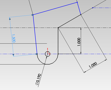

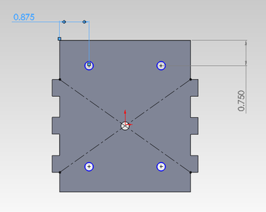

Step 3: Drill Holes in the Back Head Piece
You will need to drill a total of five holes in the back head piece. Four of these holes will be for the bolts that mount the LED mounting piece to the back head piece. The hole in the middle of the piece will be used for the potentiometer. All of the holes are 1/4 inch in diameter. Drill the holes according to the image on this step.

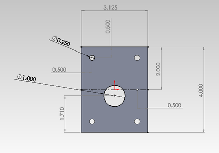

Step 4: Create the LED Mounting Piece
All of the LED components will be mounted to the 3 1/8 inch by 4 inch piece. Then, the entire piece will be mounted to the Doggy Lamp/Desk Organizer. The dimensioned image below shows how to drill the holes for the potentiometer and the bolts for mounting the LED mounting piece. However, you will also need to drill holes for mounting the tri-color LEDs and the brackets for the LED bars. In order to locate these holes, you will simply need to place the PCB on the wooden piece and trace the holes. There is a picture on this step that gives a preview of the final positions of these components.
The only tricky hole is the big hole for the back of the potentiometer. The hole should be located in the center of the piece horizontally, but vertically, it is located just short of 1 3/4 inches below the center. This measurement is not extremely important though since the potentiometer should have room enough to fit in the hole even if it is not in exactly the correct position.

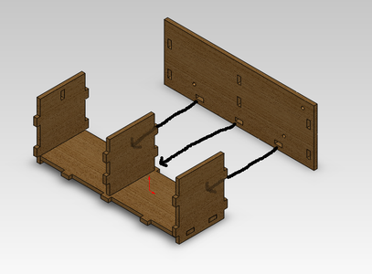

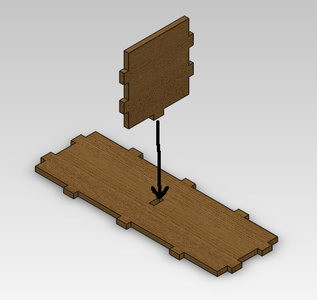

Step 5: Start Building
Since the Doggy Lamp fits together with tabs, there is a strategy for putting the pieces together easily. The procedure I use in this Instructable should enable you to put the lamp together with relative ease. Start with the piece that will form the underside of the Doggy Lamp's belly.
Step 6: Attach the Middle Divider
The body of the Doggy Lamp can be used to store office supplies, like pencils, markers, scissors, index cards, or practically any small object. The office supply compartment is divided in half by a MDF piece. Simply slide the single tab on the bottom of the middle divider into the hole in the bottom piece.
Step 7: Attach the Front and Back Pieces
The next step is to attach the pieces that will form the front and back of the Doggy Lamp's body. It does not matter which piece you attach to which side of the bottom piece, but just note that the piece that has a hole near the top is the back (the tail will eventually be attached at that hole).

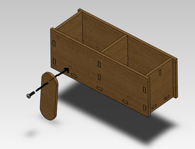

Step 8: Attach the Sides
Next, to finish the Doggy Lamp's body, attach the two side pieces. There is a particular orientation for these pieces. In the upper corner of each piece, there is a hole. This hole needs to be towards the front of the Doggy Lamp body. Orient the side panels this way and attach them to the rest of the body.
Looking ahead, the hole in the upper corner of the side piece will be used to attach the Doggy Lamp's neck. The holes towards the bottom of the side pieces will be used to attach the legs.

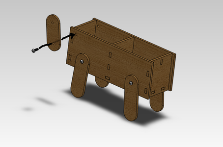

Step 9: Attach the Legs
For this step you will need the four legs, four of the bolts, and four of the nuts. Attach the four legs to the four lower holes in the side panels with the bolts and nuts. You can pose the legs by adjusting the wing nuts.
Once you have all four legs attached, set the body aside because in the next several steps, will be concentrating on the Doggy Lamp head.

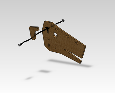

Step 10: Attach the Ears
Using one bolt and one nut for each ear, attach one ear to each side of the head. The ears should be oriented as indicated in the picture.

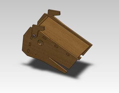

Step 11: Attach the Top Head Piece
Next, attach the top of the head. There three tabs on the top head piece, but they are not centered on the piece., The side with the longer projection should go towards the Doggy Lamp's nose.
Step 12: Attach the Back Head Piece
The back head piece, like the top head piece, is not symmetric. The side with the longer projection from the tabs should go more towards the ear. After the back head piece is attached, put on the other face piece. This complete the construction of the Doggy Lamp Head.

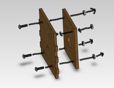

Step 17: Attach the LED Mounting Plate to the Back Head Piece
Using the four 1/4 inch nuts and bolts, attach the LED mounting plate to the back head piece. Use washers between the bolt heads and the back head piece, between the back head piece and the LED mounting plate, and between the nuts and LED mounting plate.

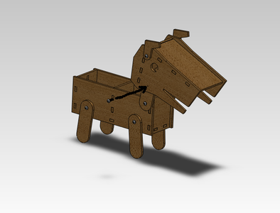

Step 21: Attach the Head to the Body
With the Doggy Lamp's head and body complete, it is time to unite them. Place the head on top of the neck so that the neck pieces fit inside the head pieces. Then, line up the two holes, and use two nuts and bolts to fasten the pieces together. Note that you can change the angle of the head in any way you wish.

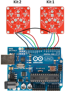

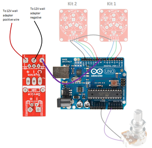

Step 26: Wire the Tri-Color LEDs
Showing the wiring inside the Doggy Lamp gets a bit confusing because there are a lot of wires and it is somewhat dark. So, the next several steps will use schematic-type drawings to show you how to hook up the wires. The important part of wiring the various components together is to make sure that the components are all plugged into the correct ports on the Arduino Uno or else the program will not work correctly.
So, the first step is to hook up the tri-color LED breakout kits to the Arduino. There are five connections to each board that since step 14 have female headers soldered to them: a power (Vcc), a ground (GND), a red, a blue, and a green pin. We will leave the power pin for a later step because we will need to connect more components to it. First, wire the two ground pins together and plug them into one of the ground ports on the Arduino. Then, connect the color pins in the following way:
Tri-Color LED Kit 1:
Red Pin -to- Arduino pin 3
Green Pin -to- Arduino pin 5
Blue Pin -to- Arduino pin 6
Tri-Color LED Kit 2:
Red Pin -to- Arduino pin 9
Green Pin -to- Arduino pin 10
Blue Pin -to- Arduino pin 11
Step 27: Wire the Potentiometer
Next, the potentiometer will be wired to the Arduino board. If you have never used a potentiometer before, check out this page for some great info about how they work. So, the potentiometer has three connections, one will be power, one ground, and the other will go to an Arduino pin. Again, we will hold off on the power connection because there are more things to attach to it. First, attach the center connection on the potentiometer to Arduino analog pin 1 (A1). Then, wire one of the outside connections (it does not matter which) to ground.
Step 28: Wire the Power Control Board
The next piece of preparation to do is to cut off the barrel plug from the 12V wall adapter and strip the ends of the wires. Now though, we will need to figure out which wire is positive and which is negative. In order to do this, stick small pieces of the 22 AWG wire into the connector on the LED bar wire. Then, plug in the 12V power supply and touch its wires to the two wires coming from the LED light bar. On the underside of the LED light bar, the wires are labeled positive and negative. So, if, when you connect the light bar to the 12V power supply it lights up, mark the wire connected to the positive port in some way (I use a piece of tape). If the LED light bar does not light up, then the wire connected to the negative pin is positive (the light did not work because you guessed wrong and had the wires switched).
Wire Arduino pin 8 to the C port on the thee-port screw terminal on the System side of the power control kit. Then, plug the wires from the 12V power supply into the other two terminals on the system side of the power control board with the positive wire in the positive terminal and the negative wire in the negative terminal.
