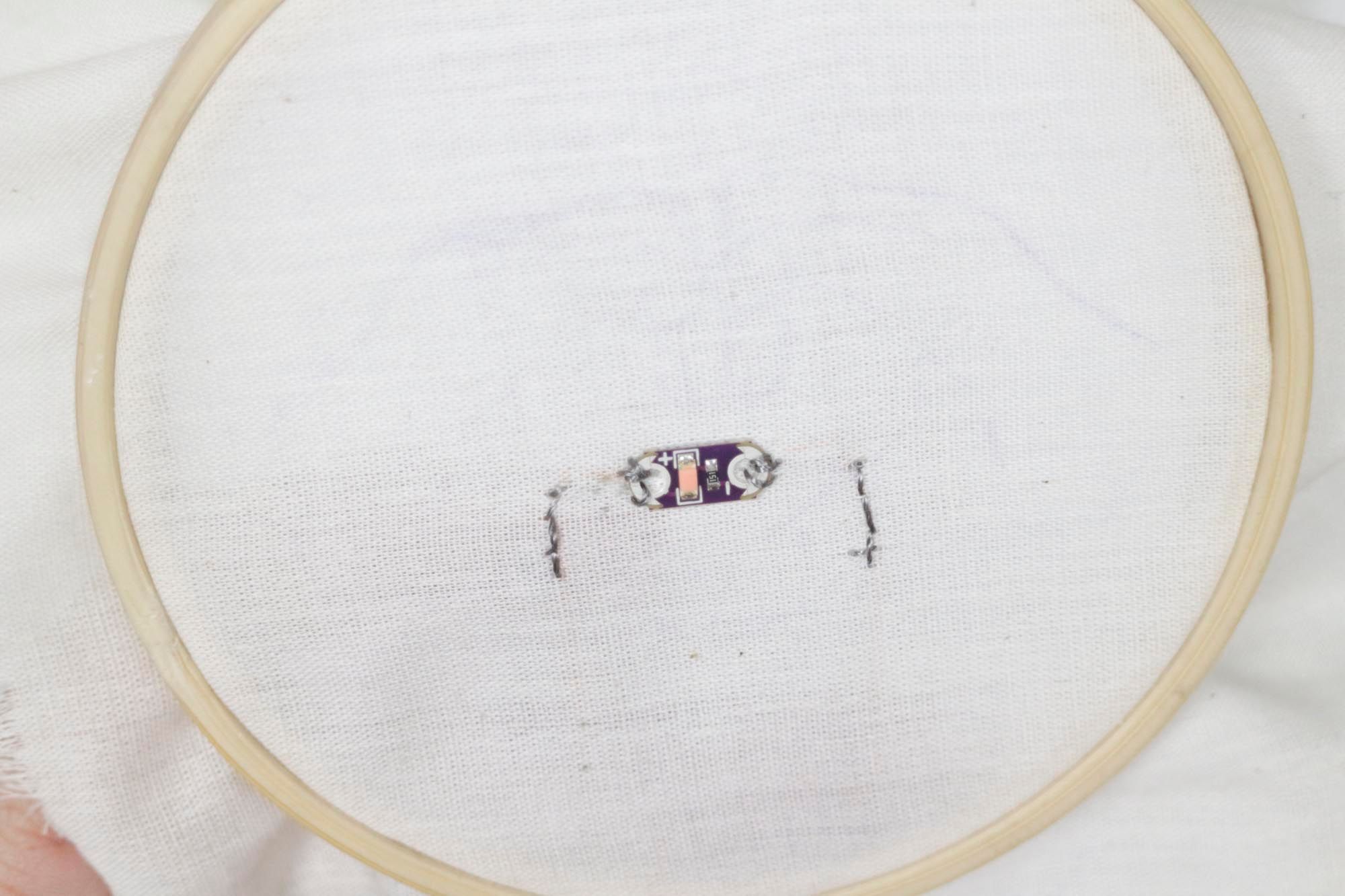

Using an embroidery needle with conductive thread, I sewed the LED into place. There is one stitch-line for each the positive and negative lead of the LED. I secured the conductive thread by backstitching and tying a tight knot with the needle. Trim the shorter thread tails.
I was left with a very secure LED and long leads of conductive thread coming out of the backside of the embroidery hoop. These leads will be used later to connect the positive and negative battery terminals.

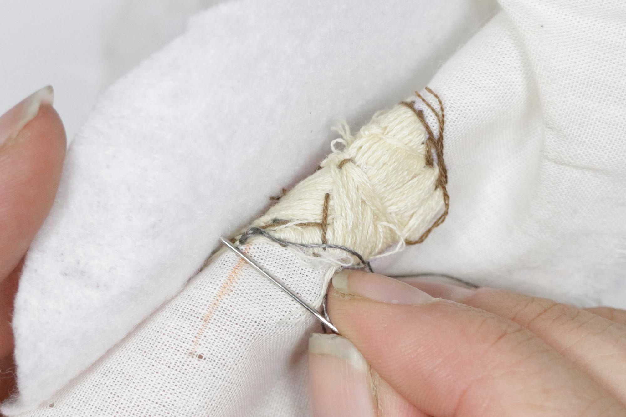

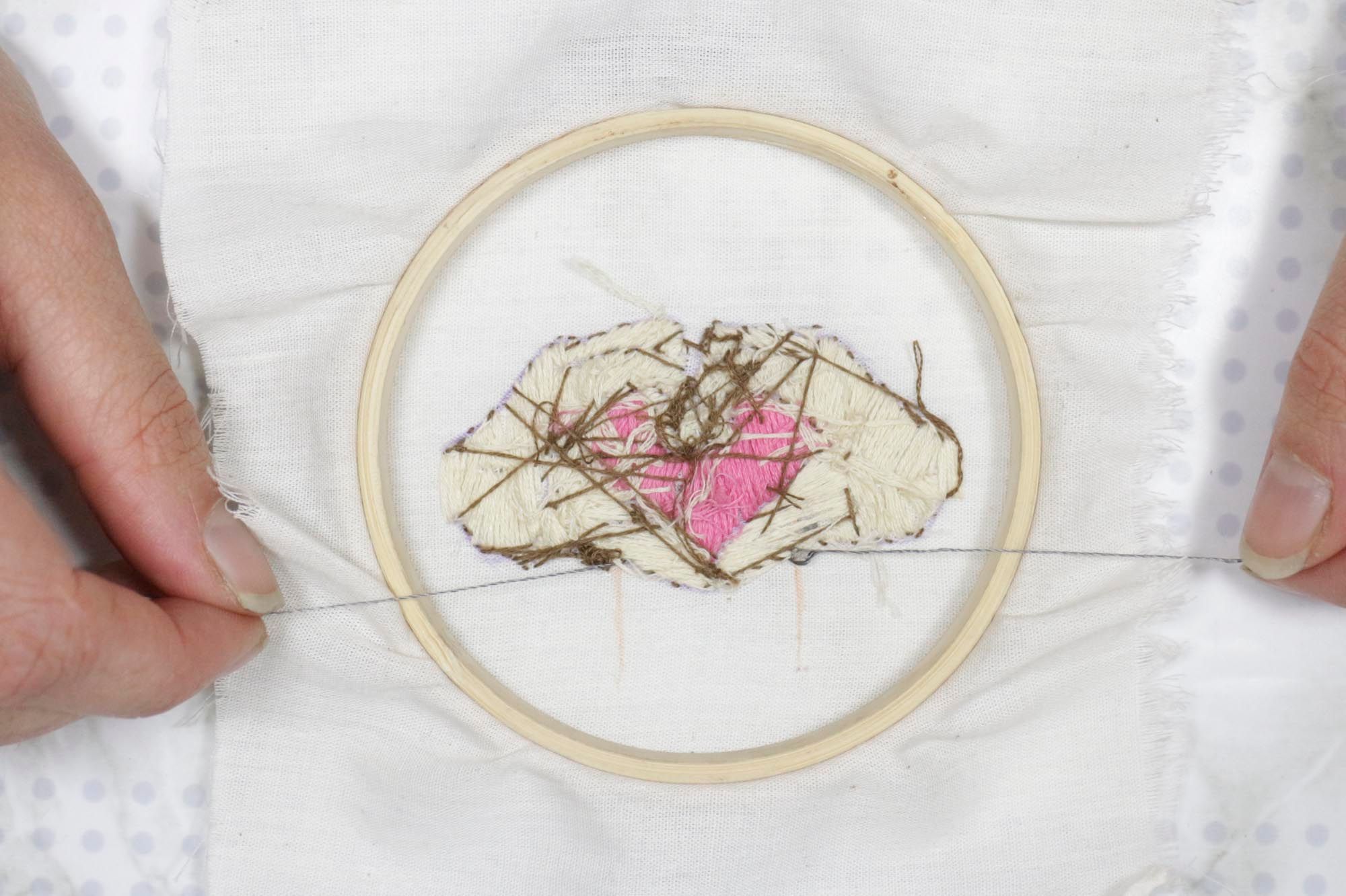

Using all the skills and stitch techniques I learned in jessyratfink's Embroidery Class, I completed filling in the design. Primarily, I used the satin stitch and chain stitch.
The two long tails of conductive thread are still accessible after the embroidery was completed. Those will get sewn into +/- battery snaps once the patch is backed.

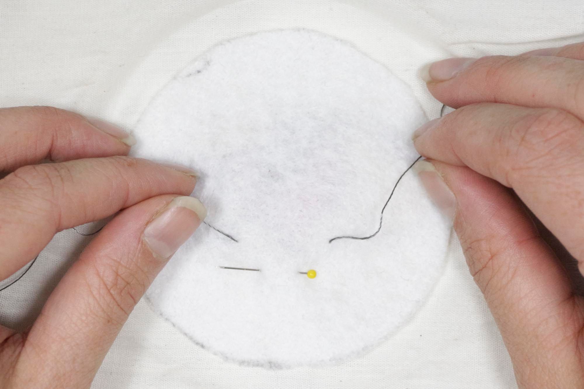

When I was done with stitching the design, I wanted to cover up the mess of my stitches with some felt. I began by removing the outer hoop and then tracing the inner diameter of the inside hoop.
When I had a circle traced on the felt, I cut out the shape and pinned it to my embroidery, close to the leads of the conductive thread.
I threaded the conductive thread back into an embroidery needle and pierced the thread through the felt so I could sew the conductive snaps on to the top of the felt.

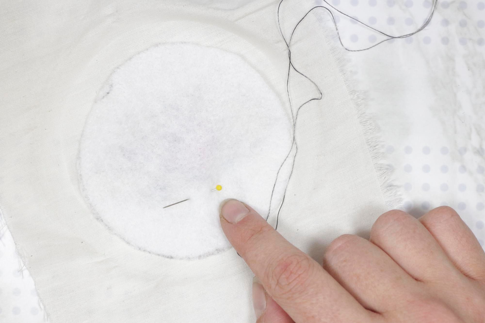

Once the leads were free from the underside of the felt, I carefully glued the felt down onto the back side of the embroidery using repositionable spray adhesive.

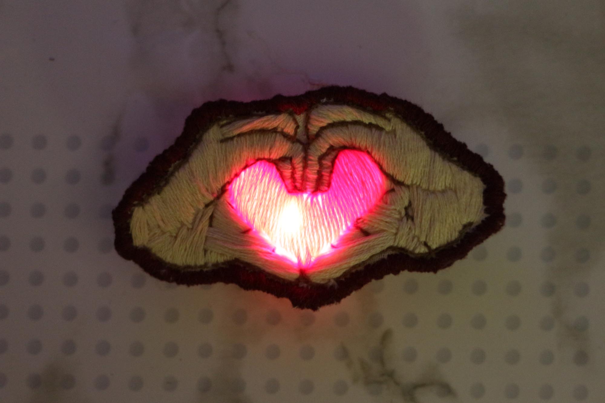

Step 11: That's It!
This patch is ready to glow-in-the-dark! Below you'll see what it looks like with all the lights off.
